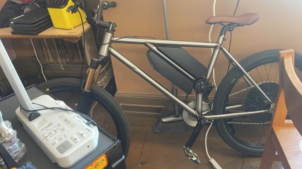

I just bought a used motoped. I always wanted this rare bike and the design is great with the hub motor mounted mid-frame and a double gear reduction, but I now realize as it’s designed its only a 2:1 reduction, so going to change from chain to pulleys and shoot for maybe a 6:1 reduction and looking for advice on what smaller hub motor would be a good fit.
An ideal motor will have a kv that gets maybe 50mph top speed with a 6:1 and 84v full charge, so a very fast hub motor which doesn’t seem available. Or is there an unwound hub motor available I could wind myself? I’m also worried about possible high eddy currents from so many magnet poles or even mechanical destruction from the high rpms. I have some stators I could use that are an ideal size but have so many teeth I fear eddy meltdown. On the other end of the spectrum I have this similar bike I made using a 83100 motor that only has 12 teeth and 14 magnets which is very few for such a large diameter, and even with multiple attempts of locking the bearings to the shaft with every type of retaining fluid and even center-punching the shaft last time.. they all still have horrendous vibrations at a low rpm from the slight play between shaft and bearings coupled with the large unbalanced magnetic forces of so few poles.
U can see in the pic the gearing from motor to jackshaft is actually a gear INCREASE and not a reduction. So backwards
I’ll be replacing the motor-mount plates to bring the smaller motor further back for more battery room so the axle size could be whatever and need not even be a true bicycle hub motor.

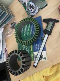

I have some stators that are 100mm diameter. I believe they would produce 1/4 the max torque of a 200mm diameter stator. They have 36 teeth. Or I could get this 136mm stator also with 36t. I think both are .2mm lams.

This battery in a steel frame box literally is hanging by its threads. Unbelievable and it looks stock.
the top tube being ..a tube is annoying for trying to mount a stable battery, hanging. I guess that’s kinda the appeal esthetically w this. Not so practical. I’m thinking I should get some kind of rectangular support frame I can weld on.

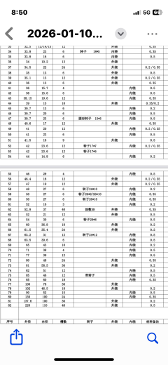

Opted for this 36 tooth stator from AliExpress. 138x30 with .2mm laminations
After finding all my stators have roughly between .4 and .8 ohms and being told they would be essentially induction ovens, and reading there’s very high resistance that’s needed for stators to pass some standards I can’t remember.. I’m realizing both that the stators we use all have resistance numbers similar to mine and that’s ok because the eddies produced are from very low voltages and result in very little eddy current. It’s not ideal and I wonder just how much better a no-load current draw would be with a stator that has truly isolated lams.
(The pics..if they finally post (my phone is crap))
Using the bigger diameter stator that’s already coated in green epoxy. The other one is for sale and also .2mm and a freak with few teeth but relatively large diameter. Will only do a 7:1 gear ratio to avoid needing a giant rear pulley which could produce horrendous sag and reverse sag from throttle and regen braking. The erpms won’t be so high and eddies won’t be so bad.
The custom crystalline hub motor that comes on these is ridiculously big n heavy. What I replace it with will be much lighter and much more open for cooling. Someday
Stator comes in thickness options.
Won’t fit as much wire but I’m going to add long radiating fan blades and scoops in the center using glued-on 3d prints
