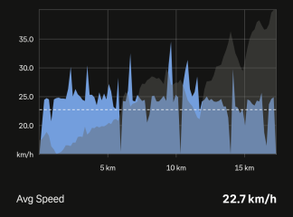

Hi everyone. I'm new to this sphere but have extensive experience in the push bike world and decent experience with RC hobbies.
I built a conversion kit for my 700c commuter bike.
My question is regarding top speed. It pulls well up to ~16km/h then feels like it cuts power. I expected faster.
The motor/controller/display came as a kit in Australia, seller stated it's for a 16" wheel that should be limited to 25km/h and that because I built a 700c wheel it won't go 25 (my maths says hub RPM x rollout = speed, and 700c>16")
The hub is a Bafang G311 250, external casing says D15, internal spline says D09, windings are 16 pole 18 slot, though I don't know what that means or if it's helpful.
The supplied display has no part number or markings. The controller looks like a generic 6A continuous unit.
The battery is a 36v 10s2p made from Samsung 21700-50S cells with a DALY 20A BMS.
700c wheel with 37mm tyre.
Have I just mismatched components and 16km/h is all I should expect from it or is the controller or display limiting my speed?
