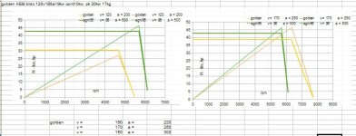

Luke, what A , V you run Golden at? to catch-up with Agni you need roughly 190/170/150v at 220/250/300a
please, tell what you and Cedric do - it's important to everybody who runs bldc

We have 680 phase amps available. We are using 500 something right now. 100v

550 will do...
...geezzz - torque - insane for this little motor
now i see why you been so excited (now i'm excited too)
