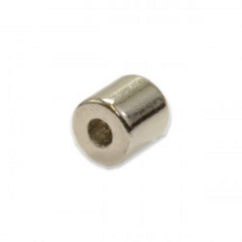

https://amfmagnets.com/media/catalog/product/cache/1/image/250x250/9df78eab33525d08d6e5fb8d27136e95/2/3/23023.jpg
I don't know how to move the picture here but 5mmx2mmx5mm magnet. the hole is 2mm, I think 14 gauge copper is 2mm and if not it will be close enough to glue in or freeze the copper to shrink and insert. so a copper electrode basically and theyre cheap
found these magnets but 5lb pull, the other one in previous post is only 1.5lb? pull. ill order some to see how they work
https://www.magnet4less.com/rare-earth-magnets-1-4-in-od-x-1-8-in-id-x-1-4-in-neodymium-ring-n42
Don't fool yourself.
The stated pull requires a certain thickness of opposite iron to meet specifications.
There is free magnetic pull calculators online where you can enter the data and get the real pull force.
I don't think im fooling myself, the magnets have a nickel/copper/nickel coating, insert copper electrode so a fuse can be soldered from the magnet to a bus bar.
if you look at the above magnetic battery build those magnets are in something like silicone and squished between two panels. SM said magnets have high resistance. this gets rid of the high resistance.
if I look at the positive button of the 18650 I think its 8mm od and the neg id is about 13mm and the button is about 1mm higher than the outer neg ring.
5mm magnet is cheaper and lighter than the other magnet and it doesn't need to be insulated from the negative and you can still use cell holders. I like to play around so ill probably plasti dip them to the cell to lock them in place. plasti dip insulates and it also grabs onto what its coating and shrinks tight and the best part is it just peels clean right off with a little bit of effort if it doesn't work. I also don't need to buy 100 or 200 to try it out, I only need to do 1 of the p groups. be nice to find the same magnet but only 3mm high or 1/8 high.
