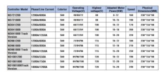

Interessting, with the 721800 I have I can set 1800A, but I can measure only up to 900A with my current clamp meter , so no idea if it really does 1800A
I may be wrong on this. Looking at old info. My sticker says 1800A/800A. I saw other stickers say 1500 and the "track" (not race) version was 1800. But the stickers indicated that. I think this is a newer one and actually good for 1800. Check out the Pic and let me know if you free with that assumption.

Here is where I saw the 1500a limit on the fardriver website;
