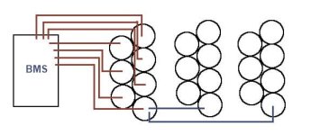

Here's a pic of my McGyver plan but it's laid out for this Filipino McGyver to understand, it's pretty simple tho. I will not be keeping the packs intact, customizing into the triangle of my frame. I will keep 2 of the packs together and still wired to its own bms(minus the plastic casings). I will build 2 packs in parallel (less bms's) then parallel these packs to 1 of the v28s still intact including parallleling the single bms connections, should act as a 7s3p pack. Same thing goes for the 2nd v28 pack left intact. Charging will be done thru the bms to keep things balanced and from overcharging. I have one charger for each bank. For ebike use I will bypass the bms thru a fuse and monitor the total pack voltage with a DrainBrain. I might possibly use the bms during ebike use to operate a LowVoltage warning LED, shouldnt be too difficult because the bms pretty much opens the circuit to the batteries when LVC is reached. Each v28 shipped uncharged, showing a reading of less than 1v thru the bms but direct connection to the batteries read about 26.9v and each cell maintains a balance of 3.83-3.84v. So knowing this I'd feel safe monitoring the total pack voltage until it gets down to around 54v (no load). Well, at least it all makes sense to me I guess.

I will build 2 packs in parallel (less bms's) then parallel these packs to 1 of the v28s still intact including paralleling the single bms connections, should act as a 7s3p pack. Same thing goes for the 2nd v28 pack left intact. Charging will be done thru the bms to keep things balanced and from overcharging. I have one charger for each bank.
Do I understand correctly, that you will run the monitoring leads from each BMS (which usually go to a single cell) to three cells (the original, plus the two parallel cells)?
Yes, thats the concept. Fechter mentioned something similar could be done with the batteryspace lipos and their bms pcb at the same time I was thinking this up for the v28 packs. I think if all the cells are closely matched everything should work out nicely. The RC guys who have been using these cells for some time now dont even use a bms for run times and they only use cell balancers once every 5-10 charges. I've read numerous RC posts about how well the emoli cells stay balanced. I'm easily convinced since I've cracked open 3 of my Milwaukee v28 packs and the individual cell measurements all fall between 3.82v-3.84v. We'll soon find out, I've got about $800 riding on this concept. Stay tuned.

Sorry if I'm being a pest...
If the cells in your small 3p sub-packs get out of balance, how will you equalize them?
This is a whole new concept here... intriguing.
8)
the 3p sub packs will constantly be connected to the bms. I dont know much about the Milwaukee bms but if it does not keep the cells balanced during discharge, I"m almost sure it will balance during charging. Its all an idea, gonna have to wait for the final outcome. If it doesnt turn out how I planned I can always use the RC Lithium chargers and balancers if need be.

Here's my concern:
If you have only one lead monitoring 3 cells, they can get out of balance.
Each sub-pack of 3 cells will show an average voltage, and the BMS can't really know what any individual cell is doing.
It will let a cell go too high or too low, since it can only see the average of the three its sensing.
So, its not really gonna be able to do what it is designed to do.
(only one 3p shown for illustration, all cells would have leads.)

Like lead, cells of all lithium chemistries balance themselves when wired in parallel. This is how each one of the 300 cells in my pack gets balanced using *only* :D 20 chargers.
In other words, given a very short time for the voltage (and charge state) to equilibrate, each cell in a parallel subpack of three cells (or in my case, 15 cells) will have the same voltage if you disconnected and individually tested.
If I'm understanding Maytag's plan correctly, it should work.
Yes, he needs to run the bms wires to all the cells. Sort of a buddy pair system. The bms will 'see' the correct number of cells, but each cell will be 3 in parallel. Each 3-cell sub pack is wired in parallel, so the voltage on all 3 cells will be the same.
