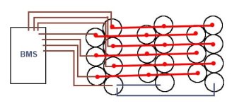

my packs will be wired together something like this, just as fechter described it. Xyster is running something very similar just in a much larger scale and instead of a bms he uses individual 1-cell lithium chargers for each bank of 15p.

Yet, in Xyster's (well-working) pack,
because there is no discharge monitoring,
when his pack ages or if a cell goes substantially off in capacity,
and they may not lose capacity all at the same rate,
then it's during the discharge phase that trouble would show up--
eventually one cell will fail and reverse, even though pack-overall-voltage
seems normal....
I apologize if my newbieness is showing.
But here's a toast to full monitoring of every cell with warning afforded or shut-down of that series string, at least, in the case of the demise of the weakest sister.
It is for this reason of wildly complex wirings that the simple big-cell lipoly pack premise appeals to myself at present.
Perhaps I'm not thinking sufficiently enough on practical, real-life long-term results from a pack.
pardon ramble,
r.
Ok, looking good here...
The Emoli chemistry is much more fault-tolerant that Xyster's LiPo, so this looks very do-able; and since it is only 3p, there will be less "masking" of a lame cell.
:D
seems normal....
You raise a valid concern I've considered too. But, due to lithium manufacturing homogeneity as discussed at battery university, unlike nickel batteries, one lithium cell is unlikely to age faster and suddenly puke and die than any other. They all age at the same, predicable rate, their capacity slowly disappearing over the years until finally they can't go as far as we need them to go anymore. Some of my subpacks are about 6 months older than others. I can tell because the voltage on those older subpacks declines a little bit faster than the newer. In addition to the full-time voltmeter on my handlebars monitoring the whole-pack voltage, for long rides I bring my DVM and measure one of these low packs through its charge port. At this time, the weakest subpacks at 50% discharge are about 0.02 volts less than the newer subpacks. Since they age at the same rate, I expect this small spread to remain about the same.
My next little project is to also mount a digital voltmeter to the handlebars for monitoring only the weakest subpack. So when I'm out on the road I'll see something like:
Voltmeter A: 76 volts (3.8 volt/subpack average)
Voltmeter B: 3.78 volts
I'll know to stop when Voltmeter B reads 3.70 volts.
