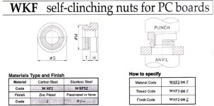

Thought I would throw this up if it is useful for this build or the next version. I started to use these self cinching nuts in PCBs a few years ago. They have worked well for me. They are a self cinching design with a serrated barrel that you press into the PCB. I typically use a very small arbor press to do it. When you get the plated hole size correct they insert easily and hold well. They are sometimes difficult to find in small quantities. They are typically zinc plated carbon steel, so conduction is not the best. Data sheet attached.
Standoffs are available in many heights and can be cut, only enough height is needed to take screw threads from both sides.
Alternately a metal block can be drilled and tapped so the PCB mounting holes are offset from the FET mounting holes
Alternately rivnuts or some other captured nut could be used.
And there are other commercial products such as those bigmoose suggested (I didn't see his until after writing most of this post).
Nuts soldered to a PCB will likely fail in tension.
