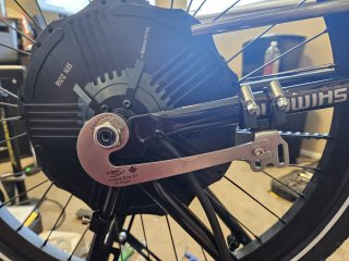

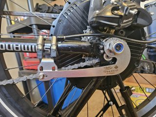

Grin v7 torque arms are here.
They're relatively heavy units that look super strong. All the machining is ultra tight and the axle snugness with the adjusters is awesome. It's the ultimate torque arm.
This is necessary for the RH212 because it has what seems like a 8mm wide axle instead of 10mm. This causes an insane level of slop in grin's older torque arms, and in the bike's dropouts. It's the loosest hub motor axle i've ever seen... by a lot.
I read in the manual that they recommend no more than 50nm of torque per torque arm. That means that despite this extra strength, i still need two of these heavy torque arms, especially considering the weak axle.
If i could go back and do it again, i'd get a leafbike 30mm wide stator motor that had a proper thickness axle and didn't require these special clamping torque arms. The motor is already heavy as it is.
I think this wimpy axle limits the power i can extract out of this motor too without snapping the axles. I'm going to limit the power to 40A batt, 100A phase, aka 2kw.
I read in the manual that they recommend no more than 50nm of torque per torque arm and found myself quite disappointed. That means i still need two of these heavy torque arms for the 105nm of power this motor is projected to produce.
Not necessarily...
I've got one clamping torque arm on one side and for the other side I just fully clock it's 'legacy' torque arm before tightening up.
This has worked fine for over 10000km so far.
Cheers
Yeah... i just wouldn't trust that on this motor!
..thanks for prompting me to second guess myself.
I think i was crabby yesterday because so much of my ebike shit has been giving me grief like non stop.. both new and old.
I remeasured things.
The axles measure 10mm +/- 0.1mm.
..except for this point where the side with the cable ( disc brake side ) is right next to the frame.. this is where i get that extreme slop in the torque arm... and you also have a huge hole within the mounting interface.. it's not confidence inspiring..
The other axle that's solid is just average width, but.. not a tight fit with the ol' grin v5/v3 torque plate... whereas the leaf was a nice tight fit and i believe i had to hammer the Grin TAs on.
Okay, this axle interface is less wimpy than i was thinking and i turn out to be bad at eyeballing millimeters.
I also weighed the pair of TAs and it came out to about 520g, or 1 pound. I think their weight is deceptive in the hand.
The resulting fit is one notch away from "that's not going anywhere" status and the tightness is a massive improvement over regular TAs. I think i feel confident with this setup.
CD, if you have 10000km on this setup then i might be under-estimating the holding power and everything is probably oK!

Yeah, it should be fine. I'm not using the V7 torque arms, but just have the one side clamped.
As a point of comparison, I ran (and needed) dual clamping torque arms with my old Stealth Fighter pushing 8KW. Prior to that I ran simple torque blocks at 5-6KW and it was a nightmare keeping everything tight.

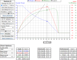

I can output 250-300w to the pedals for at least 5 minutes, and i've lost a bunch of weight recently. So i re-ran the numbers on the Shengyi SX2 with a 26 x 1.75" wheel.

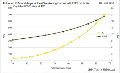

In this worse case scenario for my around-town jaunts, the motor is making 213 watts of heat. The hills in my local area are short, so this motor is just barely up to par for that duty.
Top speed on the flat, efficiency, and range are all awesome.

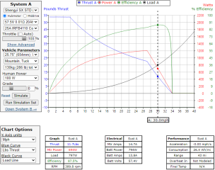

Interestingly, 57.5v produces 0.1% better efficiency on the flat. 30mph and the motor is producing 99w of heat, which it can probably sustain indefinitely. 60V is where efficiency starts to drop again. Incredible performance for such a small motor.
I think this motor would be happy with a little flux weakening. I'm only looking for a 9% speed increase to hit 30mph. I'll use the VESC controller's feature that allows flux weakening over a certain throttle percentage to limit my use of it.
Per this thread:
Compact Field Oriented Controller, ASI + Grin, limited run
A 30% speed boost produced a 8% efficiency loss. Napkin math tells me my efficiency loss will be 2.5%, and this loss should be at the controller. Not bad.

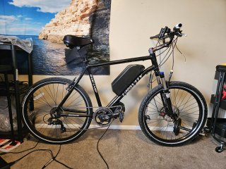

Need to resend the all axle back to ebikes.ca for respoking and re-statoring, so i put the lightest mid drive on Mini Hiryuu so i can enjoy what looks like the last 2 days of rideable weather.
Bike comes out to 55lbs, not bad considering that 10lbs of that is due to comfymaxxing. I think a 29er version of this would require less comfymaxxing and therefore be a bit lighter.
I love the nice weight distribution of this thing now.
I'm thinking v2 i build next year will have 29" wheels and put some of this weight savings towards a 50% larger battery and still fall under 60lbs.. which is the point where an ebike starts to feel like a bull in a china shop when maneuvering it in tight corners in an apartment.

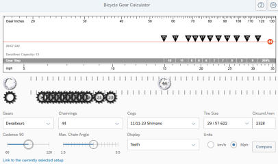

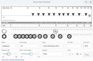

Also looks like a 44T chainring would be sufficient for hitting a max speed of 32mph or so in single chainring mode.

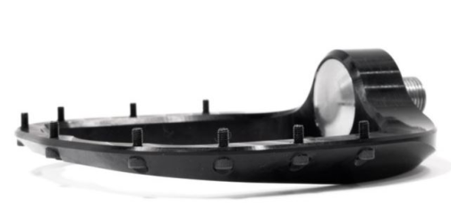

Another option to utilize a 29er frame is to use these expensive pedals that drop the foot position by 12mm. This way i can retain the rear 29" tire and have okayish standover height.
Looks like 30mph is still achievable with a 29 x ~2.25" rear tire and a bit faster pedaling cadence
This does make the 32" option look a bit silly because a 29 x 2.5" in the rear is gonna be close to an inch difference diameter vs a 32 x 2.15".

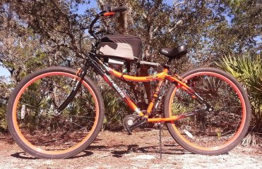

Existing bike
24 x 2.2" = diameter 25.63 inches <-- where i started
26 x 1.75" = diameter 25.477 inches <-- current tire
26 x 2.5" = diameter 26.97 inches <-- could step up to this size with the pedal hack
Bikesdirect 29er - $379 free shipping
27.5 x 2.0" = diameter 26.956 inches <-- what i planned to have on the rear wheel before the pedal hack
27.5 x 2.25" = diameter 27.46 inches <-- actually 27.5 inches
29 x 2.1" = diameter 28.65 inches <-- stock size
29 x 2.5" = diameter 29.45 inches <-- optimistic max with pedal hack

These fancy pedals are on a kickstarter and going through their first production run.
I can't depend on the pedal hack working to lower step through and get good rear diameter.
If i'm stuck with the 29er, to reduce stepthrough, i need a 27.5 x 2.25" on the rear, which has a diameter of 27.46 inches.

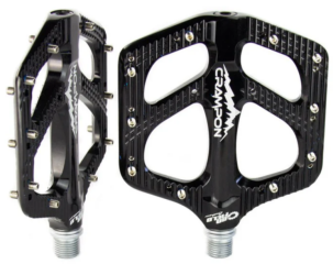

Googling, i find:
Ultra thin pedals with 2 bearings ( good! ):
Crampon Ultimate Pedals - BOGO 1/2 OFF
