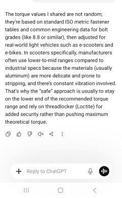

Haha, I just realized what a mess I made with the torque values. It was all due to an AI-generated chart that had errors.
For example, a bolt that uses a 5 mm Allen key was labeled as M5, when in reality it was M6. That happened across multiple bolts, so I ended up significantly under-torquing everything.
I’ve already corrected my references to do it properly now. According to the updated values I’m using, M6 bolts with blue Loctite should be torqued around 7–9 Nm, and M8 bolts around 16–20 Nm.
Does this sound about right?

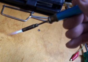

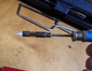

I had to adjust the angle of the brake levers, since they came from the factory at a pretty bad angle and already had blue Loctite applied.
I ran into an issue with one of them because the bolt wouldn’t come loose, even with a lot of force. I heated it up for a few minutes using a soldering iron—first attempt didn’t work. Then I heated it again, and just like people say, it finally broke loose on the second heating cycle. :)
I took loctited brake rotor bolts off a motorcycle wheel recently, a substantially more serious job than bicycle of scooter stuff. All I used was a little gas pencil torch that got right at the centre of the bolts. I gave each one 10 or 12 seconds and that was enough to cook the compound and all the bolts to came out easily. You don't need a big flame hey, just hot and precise.

That’s a really good idea—quick and effective. I had also thought about buying one of those mini torch lighters, but since I already had a soldering iron available, I decided to try that first.
My heat cycles were around 5 minutes each. I’ll see if I can find a small torch at a smoke shop—the smallest flame possible—since I’ll need to fix the whole mess my past self made. :cautious:

Would anyone recommend using the torque values from this chart?
I don’t have much experience tightening bolts, and doing it without a torque wrench leaves me unsure if I’m actually getting it right. The fear of stripping or breaking something might make me under-tighten them.
That’s why I was thinking of sticking to the minimum torque values from the chart and using Loctite, maybe as a safer approach rather than guessing.
I just want to know if those M6 and M8 values look correct, since those are the bolts that hold the stem. Any advice to help me get this right when I work on it would be really appreciated. Thanks!
