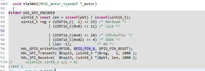

I am now trying the use of encoder tle5012. I am looking at the code and I see PB8 being used,
but in the pill schematic, I do not see it being connected.
What would be the correct pin?

Pb8 is normally a CAN pin so that's an unlikely choice. From the position it looks like this is for SPI select. Change it to whatever you have available for the chip select pin... Not USB or serial or canbus or the pwm/analog pins... F405 might like pd2 for example?

I will give it a try once I get the connector to my encoder breakout board. Thanks again.

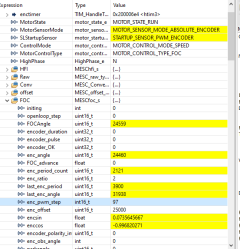

I hope you still have time to assist me. I have connected a TLE5012 sensor via SPI and I am now able to read the sensor angle. I made a slight change to the code so that it uses GPIOC Pin 11 as the chip select and then to use the sensor output to update FOC angle. Using the original code, and setting SensorMode to Absolute encoder and SLtartupSensor to PWM Encoder, I could not spin the motor. I suppose the StartUp sensor is irrelevant since I have an encoder input. I modified the code adding some code inside MESC_IC_IRQ_Handler to read the tle5012 and update some settings, similar to what is done in the IC_TIMER_ENCODER block but still no luck.
What should I do to make it work? The snapshot below is after attempting to modify the code myself to see that the relevant parameters (I think) update.

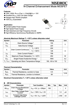

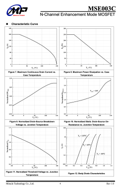

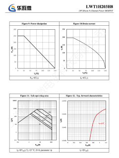

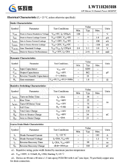

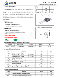

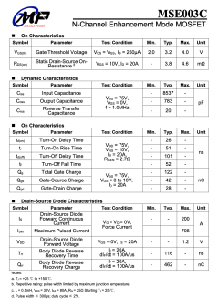

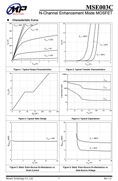

I think I have found the ultimate 20S FET, or so it appears... I am not sure because they seem a bit too good to be true and for QC I prefer to stick to the more common brand names like NCE and CR Micro when buying these types of new gen devices, I don't really bother with the premium brands as they never have the nice specifications in the same packages. Anyway, these FETs have a high breakdown voltage so there is plenty of room for safety/transients, they have a very low total gate charge, reasonably fast switching, reasonably high pulsed avalanche and the reverse transfer capacitance is very low even at 50V. These are better than most 85V FETs which make them seem almost unreal. It looks like they need to be kept cool but you are rewarded with exceptionally good ratings on nearly everything. I wonder what they look like under load? I can't test them properly but maybe someone else can. What's also bothering me is that LCSC is the only place which stocks them, even GOFORD are available at places like Digikey...
View attachment 387157View attachment 387158
View attachment 387159View attachment 387160
They look great! Did you try them? I was thinking about the infineon IPP029N15NM6 for mine
