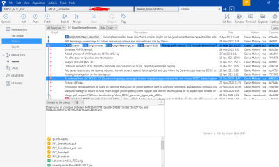

I use git command-line on Linux. This is what I did:
1. Cloned the repo on github
2. Checked-out the latest branch (#0894c6b2)
3. Loaded the project in KiCAD
But this (from your post on Mar 28, 2021) is nowhere to be seen. The pcb in the cloned project has V0.5 on the silkscreen layer. Saw no change after running "Update PCB from the schematic" in KiCAD. I'm guessing you may still have some changes in your local staging area that should be committed before the repo is pushed to origin (i.e. github). Btw, you can replicate what I did into a clean temporary directory and diff it with your main project.
Thanks,
Following feedback from zombies and others, i binned the branch rearranging it further. Never completed, never will be unless you do it.
Reason being that with more area around the FETs there will be more cooling and therefore more power. The FETs are very much limited by the amount of heat that can be conducted out of them when using the ipt015s.
I'll check later that the commit hash I gave above is good for manufacture.
Ah! that explains why. I appreciate your help very much. Hoping to place the order by this weekend.

Hi Zinahe,
I had a quick look through the hardware Repo. I have really not worked on this atall, since March this year, and no substantial changes since December last year when I made the current boards.
If you go for the "as ordered" option (highlighted), it will definitely work. I have done hundreds of miles with it with a friend on two ebikes, me at 13s, him at 20s, running something like 60 phase amps without getting hot atall.
If you want the option to run other micros, then you will have to re generate manufacturing files from the master (also highlighted). This should be fine as well, but untested. The significant difference was the addition of a 100ohm resistance between the external opamps and MCU since fresh MCUs often have weird programming pin configs that fight the opamps. You would also have to add in the INA181A1
Bear in mind that JLCPCB and KiCad have different opinions on footprint orientation,you have to manually check and edit and re-upload. The V0.5 files *should* have the correct orientations.
You will have to add a few components JLC do not have, e.g. connectors, gate drivers if they are out of stock.

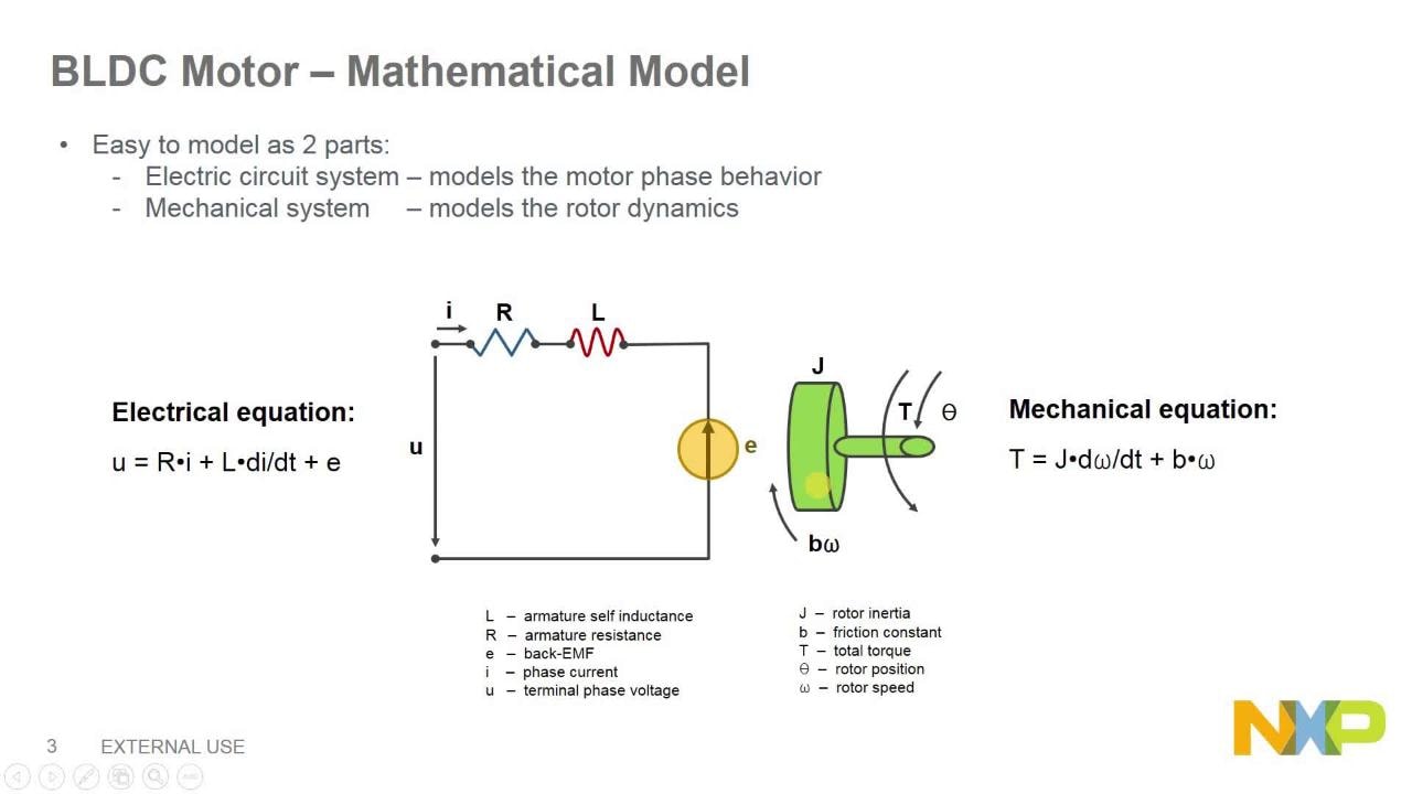

I'll struggle to explain because there's really nothing to it.
It does indeed come from fundamental equations.
Imagine you spin the motor by hand and scope it... You get a3 phase sin wave. Clearly from this, given any snapshot in time you could calculate the rotor position.
If you made the Clark transform of this 3 phase wave, it would be even easier... You'd just take the arctangent and that would be your angle.
When you're driving the motor with pwm, the same still applies but you have to account for current. You can reconstruct the voltage from back EMF from the pwm, and of course it works out to be the Va and Vb of the PI loop and park transform output minus the IR and Ldi/dt.
But this is noisy. If you arctangent this, you get the angle but with horrendous instability and it will positively feed back error the next cycle.
If you integrate however, your sin waves remain sin waves but phase shifted 90 degrees and increased in amplitude with the same absolute noise.
Thus when you take the arctangent, you get a much more accurate estimation of the angle, only phase shifted 90 degrees. So you just shift it by that angle. (Note in the code that it's 180 degrees, this is because the voltage generated is of course in quadrature to the magnetic field so there's a 90+90 phase shift).
There's nothing more to it.

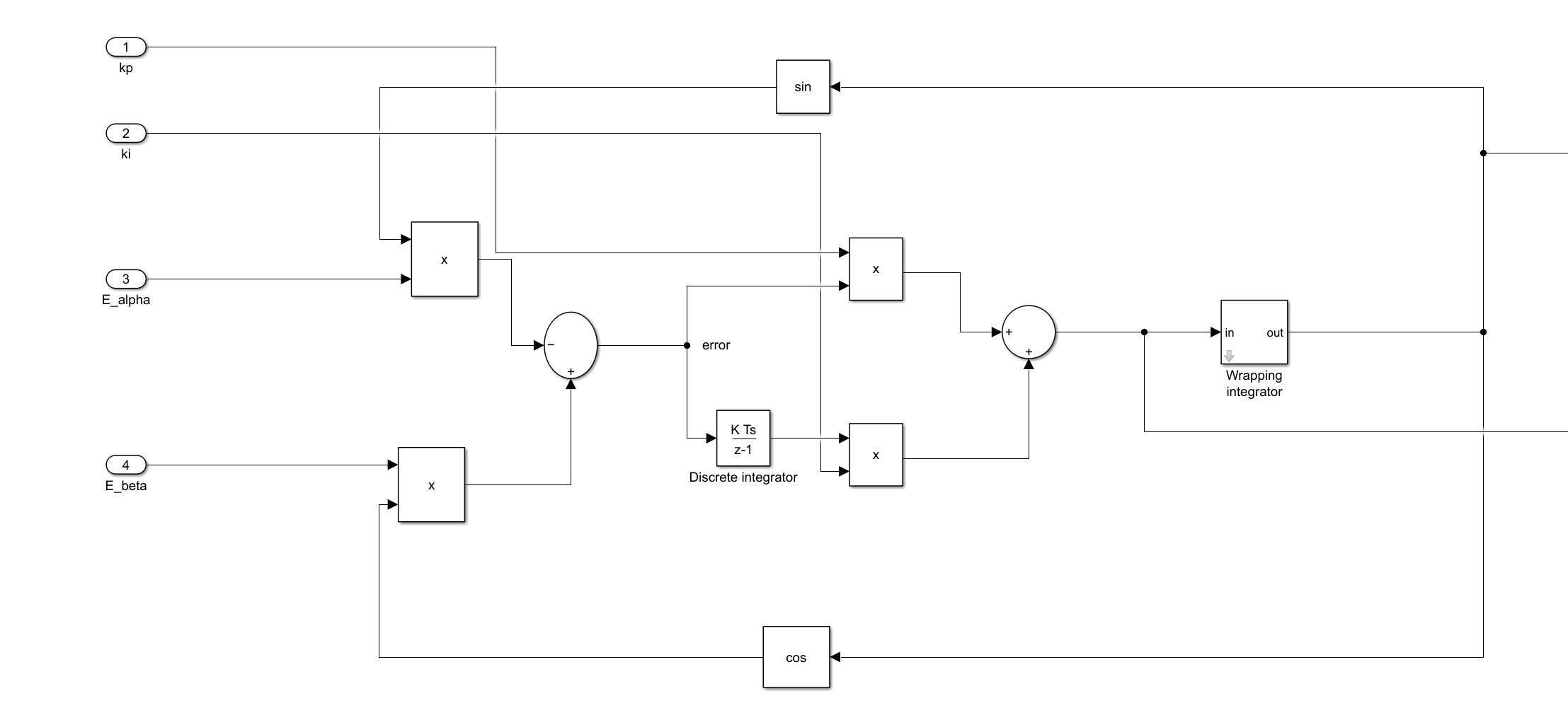

A quadrature PLL like this seems to do the trick in simulation. Output is speed, which you can integrate to position.
I would like to try sensorless foc on an stm32h7 and play around with some algorithms.
What's the transient response of your quadrature pll like? I can see that it would be good for a stable speed estimate, but I would have thought it would result in significant lag as the KTs(z-1) term catches up and you integrate that error into the output angle.
Clearly anything more than about 45 degrees of error becomes instantly unstable.
Do you have H7 based hardware? I really ought to create some if I'm going to carry on doing motors but i just have too many boards now.
Should be ok to track rapid acceleration of a small motor with a reasonable loop freq. Haven't tried on real hardware though. Another problem is that it will track 180 degrees out of phase in the reverse direction so need some logic to check speed and adjust sign of the summer to ensure smooth speed reversal.
