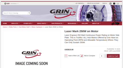

Grin did not put this label on my All-Axle motor! I did avail myself of the laser marking service, but that's in a different font in a different place, and people who are already suspicious of after-the-fact modification (which is a BIG part of the discussion about ebikes here in Australia), or people who see monetary benefit in being suspicious of after-the-fact modification (Insurance companies, possibly fossil-fuel industries if I make any headway with my advocacy) may use that as a point of attack (no, I don't care how likely this is - I want to solve the actual question, not stream my opinions out in public thoughtlessly).
If Grin themselves puts this on the motor labels, then they can be sued if the motor does not in fact pass the 250W test, although there is still the question of 'which test?' as they are Canada based. That adds the Canadian legal motor rating laws to the investigation.
Why would they be sued? The mark 250W and that can be based on their own rating criteria, like it is for all motor companies. Are they an Australian based company? The crime would be knowingly purchasing a motor marked 250W, when the seller has made it publicly known what their position is on ratings, via the article I linked earlier. Grin has no liability.

As far as I am aware "ALL" hub motors sold by Grin meet EN 15194 250W rating
The "option" to have any of their motors Laser Etched 250w Max is available in the "Accessory" section of all the motors they sell
at an additional cost of USD $15
" 1 x Laser Mark 250W on Motor + USD$15.00

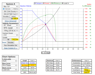

Laser Engrave 250 Watt Continuous Power Rating on Motor Side Plate. This is Truthful. ALL Hub Motors Offered by Grin Have an Operating Point (RPM and Allowable Temperature) Where They Can Only Sustain 250W.
It takes a LOT longer than most people would realize for a hub motor to reach
steady state temperature equilibrium, upwards of 1-2 hours,
while usually the longest steep hill climbs that you actually encounter on the road are over in less than 5-10 minutes. The end result is that motors will have a much lower power rating than what people routinely subject them to, and this would be a misleadingly low number. For instance, the 45mm wide stator MXUS motors are often sold as 5000 watt hub motors. At 250 rpm the core will eventually reach 100oC with just 800 watts of output power.
Grins/Justin's "Power Rating" theory
This is simple to simulate. Grin defines 150°C as overheat in the motor simulator. So I searched two operation points for the MAC 12T. One with full throttle, that gives >500W continuous power, one with half throttle, that gives quite exactly the mysterious 250W continuous power.
