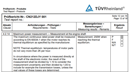

It is helpful to search for "EN 15194 Certification test report". You can find several PDFs, where the test methods are described. Example:
But especially the information about the maximum rated continous power measurement is tricky :)
In the quoted EN60034-1 a "maximum continous rated power" is not mentioned at all, see #5 o_O

I think the sentence "The maximum continuous rated power shall be measured according to EN 60034-1........" should be read as "The maximum continuous rated power shall be measured according to EN 60034-1........" rather than as
There is a difference. EN60034-1 measures 'continuous rated power' and as you say makes no mention of 'maximum continuous rated power'

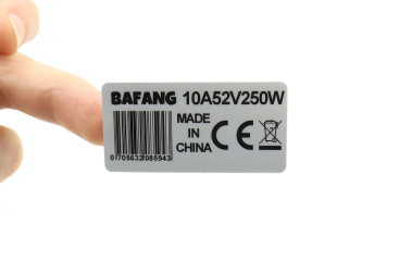

The only important thing in practice is a label on the motor that shows 250W. You can buy this label on eBay :ROFLMAO:

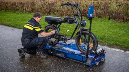

The police can measure the maximum power of a bike on a mobile test stand easily, but not the rated continuous power...

Do you happen to know how Australia measures compliance with the 250W motor rating in cases where the manufacturer has not certified it (or if the Police or an insurance company thinks someone is lying)?
As I wrote above, no. Not here. There are circumstances where tests will be required, and done by Police. I'm not interested in "maybe I'll get away with it". This is a thread about how to actually meet the requirement, hopefully by a permanent modification to an existing motor - as there are very few 250W rated rear hub motors.

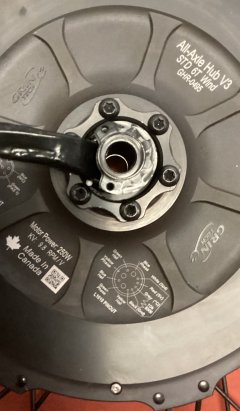

For DIY builds it's much safer, if the marking on the motor is done by laser, not by an adhesive label...

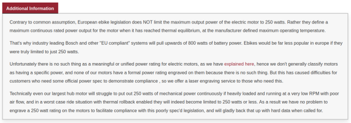

Because of these rules I chose to use Grin motors that are laser etched with 250W Max
Which Grin claim to be able to "back up with hard data when called for" which I presume would be admissible in Court......
"European ebike legislation does NOT limit the maximum output power of the electric motor to 250 watts. Rather they define a
maximum continuous rated power output for the motor when it has reached thermal equilibrium, at the manufacturer defined maximum operating temperature"
Any tests performed by 3rd parties to test a motors power would theoretically have to match the motor manufactures testing procedure/parameters and rating when it has reached thermal equilibrium, at the manufacture defined maximum operating temperature.
Any 3rd party tests that were not performed according to the manufactures defined operating temperature would then, surely, be inadmissible in Court.

"European ebike legislation does NOT limit the maximum output power of the electric motor to 250 watts. Rather they define a maximum continuous rated power output for the motor when it has reached thermal equilibrium, at the manufacturer defined maximum operating temperature"
