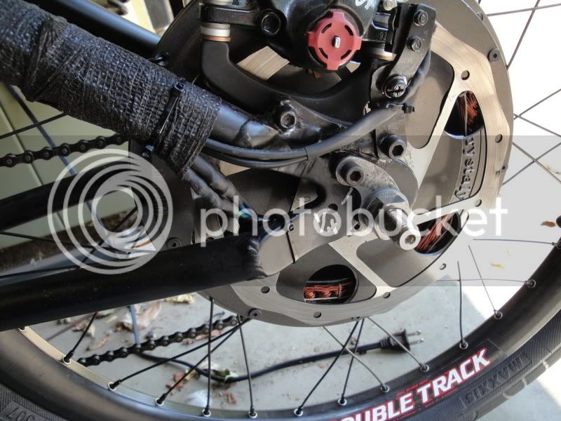

I have an almost brand new 5T MXUS motor.....originally i was going to use 110 volts nominal system but I wanted Adappto and now its 86 volts nominal the 30 volts drop means I need a 4t to get the speed I wanted(i get about 42 MPH wether its on normal or overdrive)....so anybody interested?..my plan is to swap stator and covers and use existing shell (i already built wheel)....so it would be a slightly used 5T (about 10 rides) with V3 shell and magnets
edit..i boosted up amps to 35 got up to 48 mph probably helped by a little wind....still want the new version with thicker wires since i am going to have to use more amps now that i am only at 86 volts
venting my V3....did the left side holes...thinking of putting "doors" on other side to scoop in air so it can escape other side cooling in the process

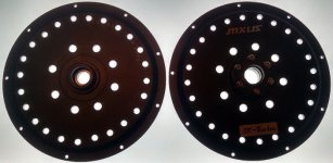

i saw all the posts above was thinking 4t gave more speed but less torque than 5t regardless of amps.........i was also thinking of venting/increasing phase wire size on 5t while i am using 4t
also...regardless of speed at same amps a 4t SHOULD run cooler than 5t correct?
(i made center holes a tad bit bigger after photo (roughly 3 times more area since there are 8 center and 24 outer holes)

Small holes wont do that much(they will work like airpockets), better to go with fewer larger holes(helps to scoop up Air). If you motor gets hot you probably have wrong tuning on the controller.
