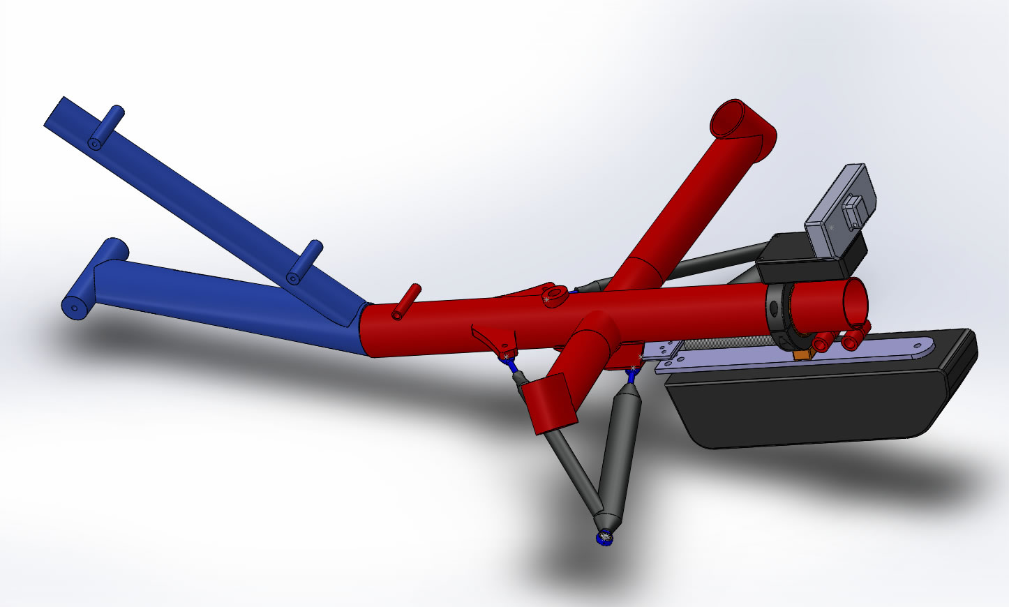

A list of new components that have arrived over the last few months up until today, that are sitting due to lack of time to install them(I can't take this trike out of commission because I use it for work and idiots keep smashing their cars into the Milan which was supposed to be my backup bike and is in need of repair yet again):
-adam333's rear suspension kit, w/ gas shock option
-ASI BAC4000 controller
-Leafbike 1500W motor w/3T wind built into a 20" wheel w/freewheel compatibility
-DNP Epoch 7sp freewheel 34-11T gearing range
-new KMX proprietary 32-spoke wheel hubs
-new KMX rear derailleur hangar
I'm about to order a 16x1.6" motorcycle rim with 32 spoke holes and a Mitas MC2 16x2.25" tire and matching innertube for my Leafbike motor. I've been intending to get some Schwalbe Marathon Plus 20x1.75" tires but everywhere I go they are out of stock. Currently seeking info from Schlumpf about whether they have an HS Triple available, as some have bought a Mountain Triple, and looking into a new torque sensing bottom bracket that is built in a way that I can chamfer it. I don't have any new batteries on the way yet, as I'm waiting for battery hookup to get more Panasonic 21700s in stock so I can build anything from a 20S5P pack to a 20S7P pack.
I have a lot of work to do to get this vehicle prepared for the performance it will have. The 1500W 3T wind Leafbike motor paired with a BAC4000 controller will allow car-like acceleration from a stop up to its estimated top speed of over 70 mph.
It is. My KMX spindles are 32h though. Which I meant to say I needed two rims for them. I was initially intent on doing all three wheels. I still might, but I'd like narrower rims than 1.6". Looking for 1.4", especially for the front, with a 32h spoke pattern. The rear wheel is getting the 36h pattern, which is commonly available and one with a 1.4" width is already on the way. I need the rims narrow enough that I can still fit normal 20x1.75" bicycle tires if I must, but with the option of using Mitas MC2 16x2.25" tires. If the Mitas 16x2.25" induce too much rolling resistance for it to be pedalable faster than a normal bicycle with the motor shut off, then I'd simply keep just the rear tire as such and switch the front to Schwalbe Marathon Plus. The narrower DOT rims also keep the weight of the rotating masses down, which should help keep it reasonable pedalable.
Getting this right is going to be a fine balancing act. It needs to be easy enough to pedal sufficiently that it retains some of the speed advantages of a velomobile over being unfaired, while also being durable enough to cruise at highway speeds when the motor is in use. I'm also going to have to make custom spindles that are sturdier than the stock ones, and a roll cage.
If I pull this off with the KMX, I'll be able to improve upon it by making my own custom platform. That platform would ideally be suited for a range of vehicles beginning with an unmotorized but overbuilt velomobile of about 70 lbs, and ending with a single-seater car of about 150 lbs with no bicycle drivetrain at all that has roughly one horsepower per pound of vehicle and an accelerator/brake pedal/rack & pinion steering. Sharing the platform between this range of vehicles allows a wide range of applications to hopefully keep production costs down by increasing volume, with the end goal being a base vehicle that is an affordable non-electric velomobile with aerodynamics comparable to a DF velomobile. The demand for the electrified velomobile and car versions would drive production and sales of the platform up to keep per unit costs down.

Adding a rear suspension kit, which will allow me to recline the seat further back for a lower center of gravity while extending the wheelbase an extra 2 inches, in addition to potholes no longer being as capable of launching the rear of the trike into the air, will improve cornering. How much so remains to be seen.
There are tadpole configuration motorcycles that can out-corner most cars. I don't think my KMX will ever come close to those due to the unique design parameters of my project, but if I can get its cornering capability in terms of lateral Gs comparable to an economy car using cheap tires, I'll be quite pleased.
