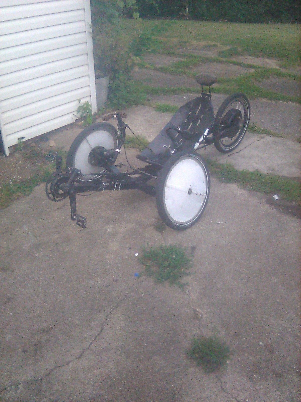

I have air in the shock and the suspension is tuned:
Once the Loctite 262 arrives, I will take the screws out one by one and apply the Loctite, then re-insert.
I still have to put the seat back on, get the brakes/shifting working again, re-make the battery box and mount it, and hook everything back up.

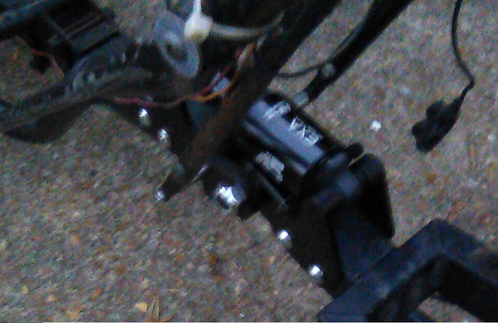

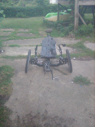

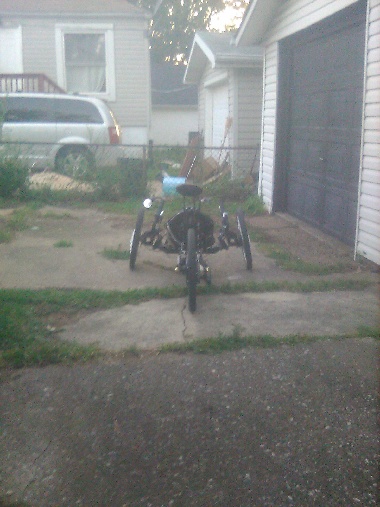

Took the first ride in the streets with full suspension. The battery needs to be split up and attached under the seat, so this ride was entirely pedal-powered, since the battery is no longer mounted. Because of the rear suspension lifting the seat and lowering the front when I get off the trike, and because of bumps lifting me at speed, underneath the boom is no longer a viable place to have the battery mounted. On the next shell, I'm getting a rear firewall and all the electronics, with the exception of the CA3, torque sensor, throttle, and 12V lighting/signals, is being isolated from the rider area. My seat is now as far forward as possible and is as reclined as possible while still allowing the rear shock to travel without interference.
I must say, going downhill at 30 mph and deliberately hitting deep potholes showed me that I barely feel them! With the more reclined seat, tipping it is much more difficult to do. I deliberately cornered tightly at speed and it didn't go up on 2 wheels. It wanted to skid instead. This is encouraging. I want to be resistant to tipping when cornering hard. Previously, this build could still tip if I was careless, and have had it up on 2 wheels a few times(mostly deliberately) before removing the body and doing the recent changes.
Pics below:
Very happy I did this mod. It was necessary for the speed and performance I intend to eventually have with this machine.
