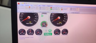

i need your help for something maybe stupid but its driving me crazy, i connected my fardriver to the pc i have the data, but its impossible to change the overvoltage protect and restore , since im 72v the previous owner at 90.7v.
no matter if i change the value, it either became gray (cannot overwrite) and when i can, the otiginal value cames back instantly, i dont even know how to save, i usualy use the app phone but i can't change on it . thanks to anyone
IMG_20230321_222431.jpgIMG_20230322_111640.jpg it doesnt allow me to change it
