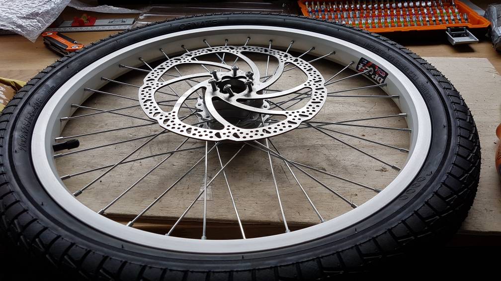

Hello guys,
Here are some progress.
My programmable controller has soft acceleration parameter, so I may not stretch/broke everything...
I'm still waiting for the motor..
