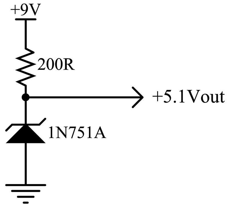

Sounds like your meter is way off!
You "adjusted" it, before finally replacing the battery. Recommend you purchase another and compare-adjust back to proper setting. Or compare with someone else's meter and adjust.
DrkAngel said:New unused Alkaline are about 1.63V ÷ 1.57V = 1.038 x 4.05V = 4.20V
Looks like your 4.05V metering is actually very near 4.20V.
You should confirm voltage against other meter, then adjust.

If you have a radioshack or similar near you, you can also buy a Zener diode for a few cents as a reference. Any voltage power source, an appropriate resistor, so you're not short circuiting, and then "read" the voltage at either end of the Zener like below: (they're using a 5.1v zener)
