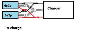

Your charge 2x diagram has two chargers. I don't get that. Also what are Anderson connectors?
Alternative charging method.
3 separate charging methods diagrammed.
Charge 2x - for 2 chargers or 1/2 pack charged at a time
file.php
Charge 1x - for 1 charger for charging all cells at once (requires 3rd balance Y and additional power Y's)
file.php
Bulk Charging - for performing the simplist non-balance charge (VMA 's highly recommended with scheduled balance charges also!)
file.php

For balance charging all 4 6s packs from a single 6s charger you will need 6 power Y cables and 3 - 6s balance Y.
2 power and 1 balance always connected to charger.
file.php
4s LiPo packs will be a totally different subject! Not so simple!
I only see 4 bricks on charge 1x Why do I need 6 power cables.

Might have found "Figure 1".
Your diagram appears to use 6 double wire Y power connectors (Green).
With some unknown 2nd function for other side of Y, of 1-4. They must not be attached to charger wires at same time!
5 and 6 look to each be 2 single Y connections, so you are using 4 double power Y and 4 single power Y ... 8 power Y! ... ?
You use same 3 balance Y's but hard wire some connections. (Orange)
file.php
The 1, 2, 3, 4 in green I can hard wire everything from the plugs below them and eliminate the Y connectors all together. The other side of Y is simply all 4 bricks wired in parallel for 22.2 volts. It should be the same as charge 1x. in your diagram. That switch should be simple to find. The benefit of the switch is to eliminate any plugs or wires from shorting out on the metal box and wear and tear plugging and unplugging everything. The center position will be 0 volts to each possible circuit. That is for hooking everything up safely. The switch also prevents any mistake hooking up the wires for charging.
DrkAngel please be patient as I am still learning. If you can please look at figure 2, 3, and 4. As you said 4s packs are totally different. That is why I was hoping to find a switch that would enable me to use the parallel board Dan sent me. He sent it to use on the 6s bricks but there are only 4 of those and the board has the capacity to charge 6 bricks. That is why I want to save it for when I get 6 - 4s bricks for two more 44.4 packs. I hope that I can find the switch for the 6s packs offline at a store somewhere. In two days I get a little money and can get another metal box. The switch i can wire up as soon as I get it. I wont be plugging anything into the Lipos until I have everything in place as I illustrated in Figure 2. I just want to make sure I did not make any mistakes in my diagrams. It has been almost 20 years since I took circuits 2 at the community college. So if you can look them over I would appreciate it. Thanks Latecurtis. out
Figure 2,3,4 are under figure 1. Thanks.
I made a mistake on figure 4. Should be 6 terminals on the bottom. There is only 5. That will be a hard switch to find but got plenty of time to look for it as that 6 - 4s bricks are at least a couple of months away.
All your diagrams seem designed as 1p.
You are using as 2p!
You are trying to think way too complex.
Rig your packs as 2p 1st, then consider them as 1 pack for diagram and function purposes.
Use pos & neg power Y plus balance Y to turn 2 - 6s1p packs into a single 6s2p pack 1st and view it as such.
Similarly, pair up your 6x 4s1p as they will be used >>> 3x 4s2p.
Write your circuit diagram as 3 - 4s packs.
Do not hard wire your packs together!
Connectors are reliable and allow easier diagnosis, repair and replacement.
Less confusing?
Added dual connector with jumper wire to diagram and angled the Y wires
To switch from run to charge: KISS ©®
1. remove jumper connector
2. remove volt meter alarms
3. remove controller
.... 44.4V Battery .... 48V Controller ....
4. plug in power 2Y and balance Y from charger
(always leave Ys connected to charger )
.... 2x 22.2V Batteries .... 22.2V Charger ....
As simple and idiot proof as possible!
Unless unable to tell red from black ...
Possible with directionalized bullet connectors to further idiot proof! ... if deemed necessary?

DrkAngel please look at Lipo board post again. I know it seems complex but it is because it is much more versatile. I will be switching chargers often as bulk charging will be done with my portable Sky charger and balance charging at home with a parallel board and 400 watt mega charger Dan sent me. The Lipo board makes sense and is virtually mistake proof. All I need is plugs and would like to order those tomorrow. That's why I call it the A B C Lipo board. It looks complex but is as simple as A B C. Everything is clearly labeled and if you check out the attachments under it you can appreciate the safety features.
I would like a battery gauge instead of an alarm as an alarm is a distraction during e bike operation. So plugs and the hookup for the gauge and link for the gauge is all that's missing. Please take a second look at lipo board and the two attachments below it. If you can please post those attachments the way yours are. I only know how to post them as attachments. I hope that Dan will appreciate them as he sent me the parallel board and wanted me to use it. He also sent the lipos ,power supply and Mega charger. I want him to know that I am going to put all to good use soon and not let everything collect dust in a closet. I went to the doctor today and got flu medicine. I will be at the library tomorrow. Thanks Latecurtis out
Too complex for me!
Rig packs as 6s2p ... to start.
Half as complex to figure.
Don't see any way simpler than my diagrams ...
Volt meter alarm tells full voltage and voltage of each bank and alarm function is adjustable, goes off when any bank is near empty, when empty or when battery is killed.
I can't believe you wouldn't want a warning before or while you are damaging your battery?
Best alternative would be a BMS that cuts all power just before severe damage point. ... ?
