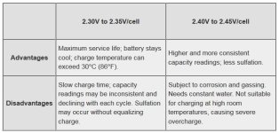

" End voltage is set to 14.70V "
Way too high! Pretty sure I told you this before ... ?
That is the maximum charge voltage for FLA (Flooded Lead Acid) the type that requires refilling with distilled water.
................................................... SLA Charge ........................................ FLA Charge .................
................................................. 2.30V = 13.80V .................................. 2.40V = 14.40V ..............
................................................. 2.35V = 14.10V .................................. 2.45V = 14.70V ..............
My BatteryMinder Charger-Desulfator charges at 14.10V then "maintains" (float charge) at 13.80V. - seemingly ideal voltages - (AGM setting)
file.php
Yup ... different chart but ~same recommended voltage limits. - SLA Gassing Voltage
