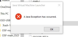

I installed java what you suggested but no luck. When I double click java configurator blue circle is running about half second then nothing. Jar configurator from @mstrens gives fault message.
Strange, have you copied it to the main folder of the OSF project?
Which JRE version do you use? Open a CMD window and type java -version

edit: I've tested it on three different computers with three different Java versions now, it works on all systems. But you have to start it from the main folder of the OSF project, otherwise the missing folder structure will cause that the GUI doesn't pop up and the process runs in background and you have to kill it manually in the task manager.

Now java configurator does not open which is OSF main folder.
This is the one from @mstrens, this isn't working for me too. The one that I compiled is called Java_Configurator_TSDZ8.jar
But of course it is from the old commit, not from the todays commit.
I get an error compiling the source, but it works, if I ignore it :)
Code:
MESSAGE Error occured while building workspace. Details:
 message: The method isBlank() is undefined for the type String; code: 67108964; resource: C:/temp/OSF-main/tools/Java_Configurator_Source/src/TSDZ2_Configurator.java; line: 5656

Thank you @stancecoke your configurator is working.
I've checked and its opening without problems (also new today version) so its problem on your laptop.
I think problem is somewhere else, because @stancecoke's java configurator is working.
I don't know anything of java. Can problem be which java version code have been written. Then it works with some java version and not with another java.
I also think that the issue depend of the java version being used.
I just asked mbrusa how he proceed to create the jar.
I expect that mbrusa will soon deliver a configurator version that works for TSDZ2 and for TSDZ8.
It should solve this issue (I hope)
@mstrens wrote: When I had installed java 8 I was unable to run the .jar
Now I removed the java 8 installation and I can again run the provided .jar
I expect that you have to install "java sdk 21" and not "java 8".

Now I am on different laptop and I installed above @mstrens suggestion of java and OSF main folder java configurator is working.
My anothrer laptop opens java configurator which is made by @stancecoke with below java version,
https://www.java.com/en/download/manual.jsphttps://www.java.com/en/download/manual.jsp
Now I ask @mstrens and @stancecoke have you been written code different java version. Or is it laptop problem?
I can maybe try different java versions with both laptops.

To create TSDZ8 configurator, I started copying the TSDZ2 configurator (.java file).
I just made some changes with a text editor.
Then to create the ;jar file, I installed a VSCode extension. I expect it installed java SDK21.
With this vscode extension I had just to press an icon (looking like |->) and I got a .jar file that I could dubble click to get the GUI.
If I open a cmd window and run java -version, I get the following:
Code:
C:\Users\pc>java -version
openjdk version "21.0.4" 2024-07-16 LTS
OpenJDK Runtime Environment Temurin-21.0.4+7 (build 21.0.4+7-LTS)
OpenJDK 64-Bit Server VM Temurin-21.0.4+7 (build 21.0.4+7-LTS, mixed mode, sharing)
