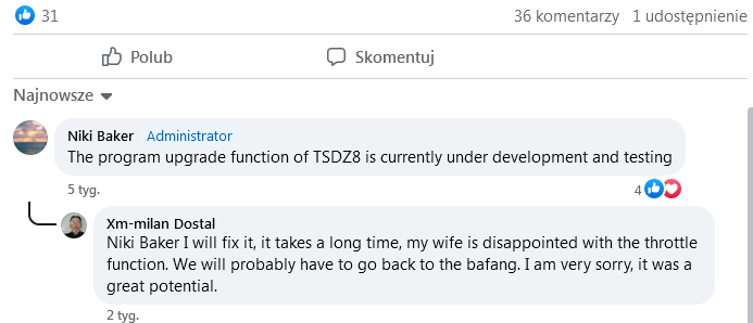

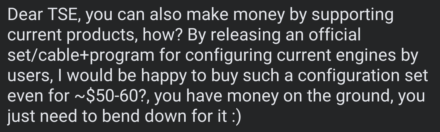

Hi everyone,
Niki Baker who has a TSE contact on the FB group some time ago declared that they are working on the option of user configuration of TSDZ8:
What do you guys say to ask them from time to time how the work on this is going? 😅
I think that putting pressure on this issue on the official FB group can speed up the process.... How about it? Do you find a moment to write a question on the group regarding this? Let them feel our breath behind their back ;)
I already took the first step a month ago, pressure always makes sense guys! :mrgreen:

I only see that he mentioned upgrade process and not user configuration, and actually motor firmware upgrade via Bluetooth from the display (DFL-11) is already possible. It is only signed firmware so no custom ones.
Hmmm, I have the impression that they also mentioned the configuration somewhere, anyway - let's ask them! ;)

Requests to get something for free + made up pressure == i'd give the middle finger to anyone begging like that.
For free? Is it the engines TSE is giving away for free? Ehh, and I stupidly paid for it :(
Also, I guess you didn't read my previous post with the link to the first post on the FB board, let me quote as a picture:

Niki or Perry once wrote that they don't work there BUT, they test for TSE their products before they go on sale, they have direct contact with TSE designers and engineers and that's a lot :)
In any case, the more Niki and Perry see configuration requests on the group, the more often they will mention it to TSE the next time they visit them ;)
