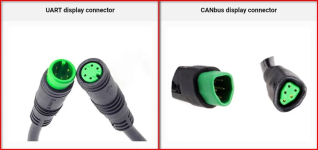

I'm happy to introduce my new open source project - OpenBafangTool.
Currently it has functions like Stefan Penoff's Bafang Configuration Tool and is in alpha phase, but I'm planning to add more supported devices (currently I'm working on support of Yamaha, so it will be available later). Now it supports all bafang motors with UART interface. The main goal of project to make modern cross-platform alternative to Penoff's tool with updates, new features and different supported devices.
You can download executables for windows and linux (AppImage) and the manual here, source code is available here.
Currently this project in early alpha phase, so please use it carefully.
