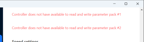

Thank you for your quick reply. The bikes do have a torque sensor and it does respond to pressure on the pedals. So, is it possible to disable the cadence sensor so that only the torque sensor is being used?
The options that are not available are mostly in the motor settings. Like how much assistance each pedal assist each level provides. Etc..
I also, was mistaken about all the devices being detected. The display's model, serial, software, and firmware were not detected in the app. The display info as shown on the display is HW: DP C18.C 1.4 and SW: DPC18CP13053.0
One other are of concern I have is that on the motor settings page it says regulations limit the maximum speed to 25 km/h. Currently the bike is set to 50 km/h. So I am wondering can I use this tool to change other settings without modifying the currently set speed limit?
I am attaching the screen shots of the display settings, motor settings, and sensor settings. I can also get any other information that you need.
Again thank you for your response and all the effort you are putting in to this project!
Unfortunately, your motor firmware have not available most of settings. This problem exists on some bafang devices, and currently I don't know the way how to fix it. Maybe it's possible to flash different version of original firmware, but currently its not researched yet. It means that you can not configure assist levels and other parameters, only wheel size is available.
You can contact Tomblarom about different firmwares for your controller, possible that he has compatible one (I don't know how to flash firmware, he knows).
About speed limit: program doesn't let user to remove legal 25kmh limit, but if bike already have bigger limit (upped by some other way) program still can work with this bike and will not change limit at all. Later I also plan to add button "Lower limit to 25 kmh (irreversible action)" for users who wants to legalize their bike
