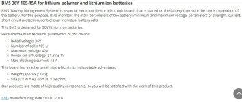

So I found pictures on a russian websites that look like the same thing (though labeled SP-R13-068-A01-M10SY)
The website ( https://el-vel.com.ua/p843133566-bms-36v-10s.html ), onced google translated, gives the following specs:
I could not find the Original Specification Datasheet from the BMS manufacturer, but I find something really close, which is the 13S (48V) version of this "BMS" called model SP-R13-068-A03.1 : http://www.sz-supower.com.cn/en/products_1.html
Here is the full PDF datasheet of the 13S version of the SP-R13-068-A03.1 "BMS" (could not find the 10S version): View attachment SP-R13-068-A03.1.pdf
And here are some more pics of this 13S version, which is exactely the same dimensions, excep just 3mm more width:
Bottom line is, from what I can read from the "BMS datasheet", this "BMS" is more just a protective PCB circuit (protects against overcharge and undercharge), but it does NOT individually balance cells. So once in a while (every once a year or so) it would be advisable to balance each 4P cell row manually, otherwise when only one of the 4P string out of the 10S 4P strings get out of whak in voltage relative to the other remaining 9 4P groups, either the low voltage cutoff voltage or high voltage cuttof would kick in when discharging or charging respectively, resulting in a less then optimal overall battery capacity in both cases...
Just thought it would be worth noting... Not a real balancing BMS, just a over/undercharge protective circuit here.
