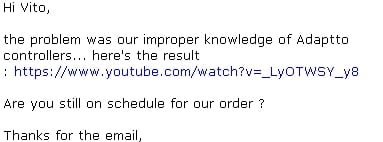

wait a mo. are you sure the chipped varnish on the windings could have or even be capable of blowing your adaptto resistor?
i would suspect not, unless you had your halls wires in direct contact with motorcase or phases also?
i would have thought it more likely that a bad solder joint or previous fault in controller would be more likely culprit for blown resistor.
JumperJackFlash said:That sucks man.
sansander.ebike said:ridethelightning said:woah!
it would be nice, if it were true
sansander.ebike said:between Phase and Stator "No"
Between Stator and Minus Hall and everything (Metall) "No"
the soldering is Good, but the individual strands that are damaged lie on one another, the in individual sectors the magnetic field is disturbed....
sansander.ebike said:a leak test It is not possible for me no devices for this.
why are you doing the test befor and not on the finished product with 1200V ? because more production steps follow......
as you can see on the Pictures stack Stators Possibly caused the damage ?

sansander.ebike said:Hi Vito,
which is very annoying for me.
yes this motor Is from Patrick. You can send him a new Motor ?
