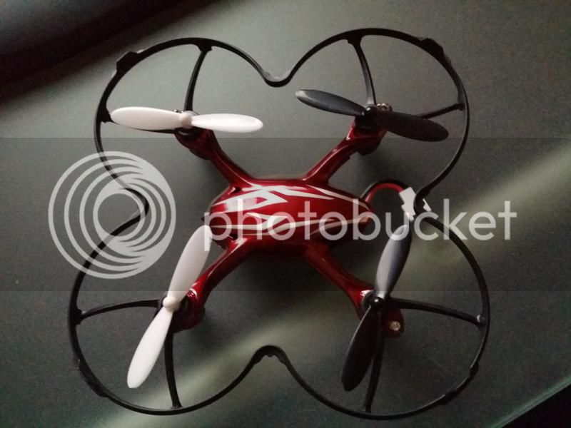

Got my Hubsan
Been through two charges...nothing broken so far. In a word i "suck" at flying :mrgreen: , throttle is quite sensitive so might try knocking that down and might have a go at expert mode. no flips yet
