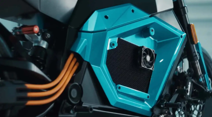

Why not grab a little fan off an old PC and rig it up to a couple 18650's and slap it on there for active cooling? Or even feed it off the traction pack via a buck converter if you have that setup.

didn't even think of that, i will try that
