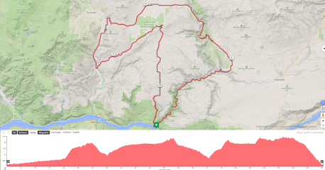

Recently purchased BMC Roadmachine Amp for my wife and I, our first foray into ebikes. So far they have been a ton of fun but we were having some range anxiety about doing some longer rides in the mountains near where we live. Searching online I could not find a good range estimator for TQ equipped bikes so decided to build one. So far its proving to be accurate and last weekend my wife did a 110 mile / 7600 ft elevation ride and used the app to verify the range. The app predicted she could make it with 11.3% battery remaining, she rolled in with 13% SOC showing on the display. Not bad. Here is a link for the app if anyone wants to check it out. Upload a .GPX file of a ride you are planning, input your motor settings and the app will estimate range and ending SOC.

Just penciling in some numbers, I see at least one reference that the bike has a 350Wh battery. She used 87% or 304Wh on a 110 mile ride. ...or about 2.7Wh per mile - which is stunningly low. I'd have to think a well lubed or poorly lubed chain could make a few watts difference. Certainly +/- a few psi in the tires could be a few watts, and we won't even get into headwind/tailwind. So any one of these could double, or half that consumption and make the prediction wildly off base.
Really, I would almost wonder, at an average of 2.7Wh/mile, she might be better off to cut the 3-4kg of 'electric' bike and just get a nice, light normal bike?

On this ride she contributed about 75% of the input energy, the battery the remaining 25%. What I have found is it does not take much assist to dramatically change the fun factor of a ride. 30W of motor input in addition to the 150W I am able to maintain and I feel 10 years younger and increase my average speed by 1-2 mph, 60W and I can keep up with just about any of my younger and fitter friends. 30W-60W makes these longer rides much more enjoyable especially on the steeper climbs at the end of ride when the legs are getting tired. I was skeptical about e Road bikes , but now I am hooked and regret that I waited until 70 to get one.
