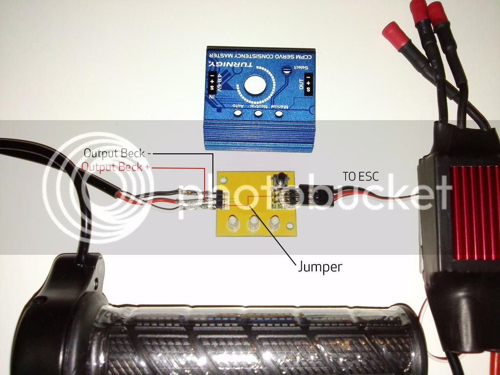

Anyone that can help me with where to connect the 5V from the bec to the modded servo tester or is this just not possible ?
just connect the output ( + , gnd ) of the BEC to the + and gnd of the servo tester, you could connect to the +,gnd of the throttle input.
Like this ?
I tried this setup but it is not working yet, what is this jumper ? Just a wire from Ebike throttle signal to ESC + ?
I have this servo as well with a cheap thumb throttle, did you get it to work after?
Hi !
This is the correct wiring for the servo-tester with non-BEC ESC :
The jumper 1 is not necessary if the ESC has a BEC
:wink:

TheGuiX said:
Hi !
:wink:
