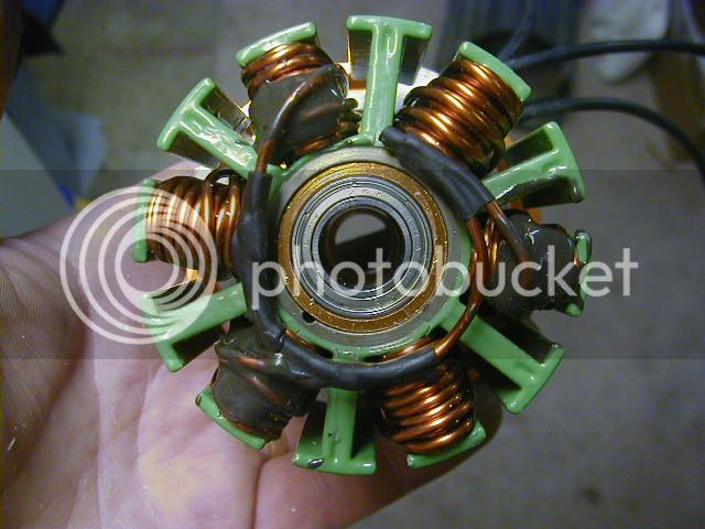

Looks great. What size wire are you using? Looks like about 14 AWG. Have you measured the phase resistance yet? I did a 9T wye using 14 AWG and it's performing well - low kV and have not destroyed my controller yet.E-racer said:I finally went ahead and stripped my 80-100 for a rewind. The goal was to be able to use a single stage reduction into a nuvinci dev kit. I choose 12t delta for 88kv. This allows me to use a 10:1 reduction into the Nuvinci for a speed range of 16mph-58mph (overdrive). Its not as perfect as Thud's rewinds but this was my first one. A couple more tries and I think I could do much better.

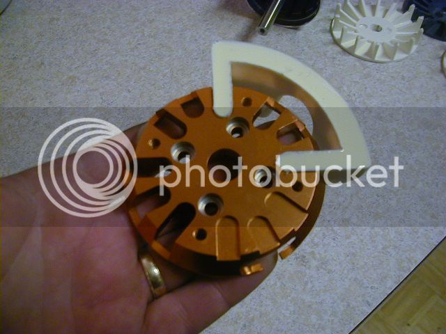

More 80mm tweeks for fun..
Unread postby Thud » Sun Jun 03, 2012 10:23 pm
Had a productive afternoon polishing the 80mm outrunners.

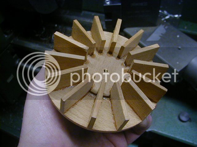

I wound a motor today to power my FS 29er build...since i will be pounding this motor, I thought I would try to air cool it with a few of my personal stylings. cooling:
The motor is wound as LRK & terminated in wye....this leaves 6x more area for cooling air to flow thrugh the motor...& odd as it seems I still have a 25% increase in copper over the stock wind's

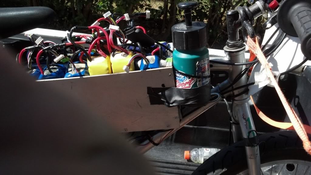

And as for the cooling mister system, I am happy to report that I was able to run endless laps in a race scenerio using misting to cool the motor. 8) Mine is a bit more "high-tech" than those of Cedric and Jozzer, but you can't blame them for trying! :wink:

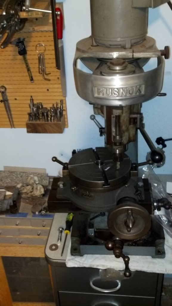

Hey Thud, on second thought, maybe I'll make my own, I just picked up a Yuasa 8" rotary table:
