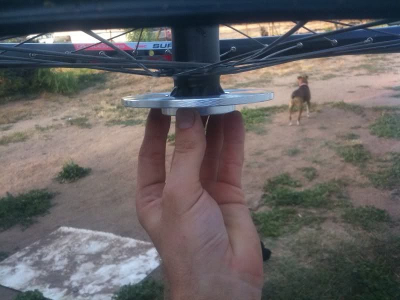

I found a convenient way to mock-up where the kart sprocket will sit before I organise a proper adaptor to hold it.
I discovered that some of the kart sprocket mounting holes lined up with the holes in an old 160mm disk brake I had lying around.
Another convenient fact is that the 81T sprocket I intend to start with is approximately 205mm diameter so it also doubles for checking possible clearance issues if I try and put a 205mm disc in as well.
So far it looks like if I move the kart sprocket inboard 10mm from the face of the disc mount on the Hub and I move the brake disc outboard by about the same I may just be able to squeeze them both in. I need to do some more detailed measurements.
I need to find a thin Hydraulic brake calliper. My Avid elixer R on the front needs about 20mm ( at widest part (where hose enters) from the centre of the disk to a possible sprocket which seems to be just a little too wide, not sure what their rear calliper is like.
Does anyone know of a narrow rear calliper?
I currently have a V brake on the back as most braking will come from regen but I would prefer to use a disk as it means I can mount the motor lower.
One convenient fact of this frame is that the rear drop-outs can be moved back about 10mm as under the alloy adaptor blocks that it came with there are 2 horizontal drop outs that go straight back. This frame is designed to work with the wheel back 10mm just using a couple of allen screws to hold it back. I think I would beef it up a little bit but the extra clearance from the seat stay would be useful for an outboard mounted disk brake.

The Alhonga mechanical caliper apparently requires less than 14mm clearance.
ebikes.ca is selling these for use with the 9C rear disk hubs (currently no stock)
http://www.ebikes.ca/index.shtml
also seem to be available at Custom Motored Bicycles (not familiar with this supplier)
http://www.custommotoredbicycles.com/wheels_heavy_duty26inch_bicycle_brakes
The Tektro Novela calipers I have require >17.5mm clearance.(I am using with 19.6mm clearance)
Very impressive project! Kudos for the Kiwi :D
Thanks rebelpilot,
Good to get some numbers that arn't normally listed anywhere else online :)
You have got me thinking. Originally I was just thinking two psiton hydraulic but these are quite wide but if I was previously happy with the concept of a v brake with regen the mechanical disks open up possibilities. Come to think about it I may have some old tektro single sided mechanical disc callipers in the shed somewhere. I replaced them with hydraulic ones on one of my bikes and I don't think I got round to selling / disposing of them so if they are anything like the Tektro you mention I may be in luck. From memory they looked very similar the the ones you mentioned in construction.
I'll have to have a look through my boxes of leftovers in the shed on the weekend and hopefully find them.
It will be tight based on the numbers you gave but definitely preferable if at all possible to have some form of disc brake so I'll have to take some detailed measurements.

Also, if you want I have what is called a "top hat" adapter that shifts the sprocket inward toward the spokes giving room for your disc brake as well on the same hub flange. Here is a pic:
You could then use washers along with a smaller disc to get the necesary clearance if this is not enough room.
You could then use washers along with a smaller disc to get the necessary clearance if this is not enough room.
Sounds interesting. I could be interested in buying one if the dimensions make it easy :). Since I don't have a lathe that was the one part I was considering paying an engineer to make but if you already have one it would be good and would save on having a custom one made.
Is the outer part big enough diameter to bolt a kart sprocket onto? ie around 150mm diameter or would it need a plate to bring it out to that diameter.
Yout top hat part looks pretty solid as I imagine it needs to be to cope with loads of pulling from a chain offset to one side.
