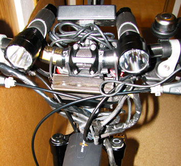

Mine is in transition; it’s about to get completely reorganized in the next month in preparation for the next road trip. However – I’ve been running with this setup (or one nearly like it between the two ebikes P0 & P1) since last Fall; L to R with me behind the wheel, the list is:
  • Bar-end mirror
  • Grip
  • Control: 3-way & Cruise (modified Hi-Low beam switch & horn button) *
  • Front Brake with custom integrated microswitch eBrake
  • Front Derailleur lever, 3-position
  • Bike People Bell <ding-ding>
  • Left Hi-Power Cree UniqueFire Flashlight, modified
  • Centerline: 6FET Controller in front, DC-DC converter on the right-side, and CA mounted behind facing the rider
  • Right Hi-Power Cree UniqueFire Flashlight, modified
  • A gap wide enough for another control *
  • Rear Derailleur lever, 9-position
  • Rear Brake
  • Throttle
Notes:
This month I will rewire the ebike to support 2WD and Signal/Brake indicators. The lighting control that I’ve modified for 3-Way/Cruise will shift to the gap on the right side, whilst the new motorcycle-grade L/R-Horn control in the vacated left spot. Mirrors are a challenge: I don’t care much for the one I have now (not shown in any image); however I really want both L/R mirrors, especially when I start pulling a trailer.
Front view before faring, with a boat-load of wiring…

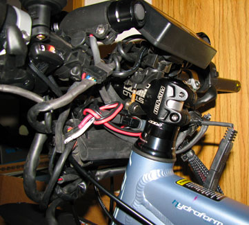

…and from the rear. The DC-DC converter is on the opposite side of the steerer.

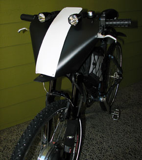

Front view with the winter faring mounted; it does a good job of slicing through the wind and deflecting rain.
Now if I can just figure out where to put my hands…

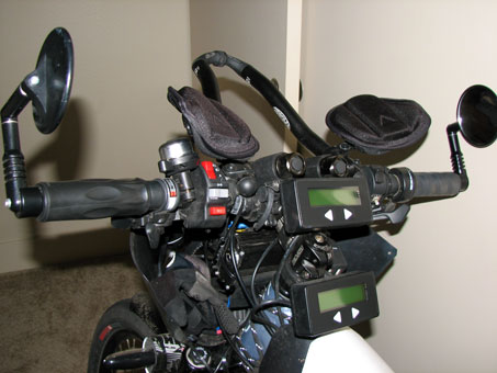

Update
I changed the handlebar assembly slightly before heading out on my road trip in July; I have kept it the same since, although I am toying with removing the aerobars cos although they look cool, the functionality is a bust and it prevents my people-bell from ringing.
Top-to-bottom, left-to-right:
  • Left Bar-end mirror
  • Grip
  • Front Brake with custom integrated microswitch eBrake (two: one for brake light and one for the eBrake)
  • Front Derailleur lever, 3-position, SRAM Attack
  • Control: Hi/Low Headlights, L/R indicators & Horn (n/c) (Motorcycle/ATV Hi-Low beam switch & horn button) *
  • Aerobar Left-mount & pad
  • Centerline: Da Black Box in front (Master On/Off Key Switch for all power, DC-DC converter which supplies the Aux power to all devices except controllers, and Signal Relay), and CAs mounted behind facing the rider:
    • Top CA is for the front wheel, and the bottom CA is for the rear. The top keeps the total Odometer reading, but I found the lower kinda flakes-out periodically, so I used it to keep the daily-only Odometer.
  • USB-Port (x2) power adapter (used for cellphone), suspended below handlebar (barely visible just above the lower CA)
  • Aerobar Right-mount & pad
  • Control: 3-Way Current Control & Cruise Control (modified Hi-Low beam switch & horn button) *
  • Rear Derailleur lever, 9-position, SRAM Attack
  • Rear Brake
  • Throttle
  • Right Bar-end mirror
Notes:
The bar-end mirrors fold in nicely when going through doorways; they are the widest part of the entire bike (including the trailer). There's a small pocket created by the faring on each side, and it makes a great place to stow my gloves when the bike is parked. The aerobars do have one useful feature: It's a great place to hang my helmet. :lol:
Cheers, KF

Kingfish, what's that fairing made from, did you make it yourself? More info on it please :) very interested in doing something similar
Hi iovaykind
This might be thread-stealing and OT, but here goes…
I made all my farings from High-Density Polyethylene (HDPE) from Tap Plastics.
Take a look at my P0 and P1 bike builds. I started out using manila cardboard or some sort of craft paper, even butcher paper will do – just something to start out with for modeling. Once you have a pattern figured out, then place it on the plastic, and trace it out with a marker. A steel rule or sometimes a large L-shaped square like carpenters use makes for a great edge to guide a sharp X-acto knife. I prefer to place the HDPE on top of heavy cardboard or plywood, and then cut against that in one stroke. Dull blades might take two – but then yer playing with danger when they get that way. In all the prototyping, I have only cut myself maybe twice.
I like to use black or white zippy cable ties for assembly. I swear I wished I was a stockholder in the company that makes then as I have gone through 100’s of them, I kid you not! :lol:
Seattle Fabrics has an excellent selection of reflective tapes and other fun materials for decorating farings, and for making epic bike bags.
One thing about HDPE is that it cannot be glued; superglue will hold for a short time on static assemblies - although eventually will fail. However HDPE can be sewn, punched, molded by heat to retain it shape, moderately stretched, and it is self-lubricating – lending a soapy-like slipperiness to the surface. Lastly, I use alcohol to clean up the marker pen when the assembly is finished. :)
These types of farings are very lightweight. The front faring added 2 mph to my top speed by slicing/deflecting the wind. The triangle bag of P1 is protected by an outer shell made of three sheets, and is stitched together with Velcro. The trailer (P2) is covered by HDPE, with the top having silver marine vinyl stitched in.
Maybe we need a thread on faring construction. :wink:
Enjoy! KF

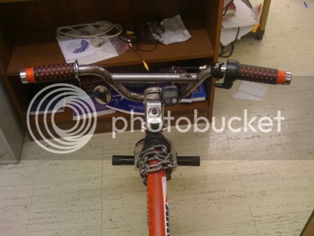

Here is my handlebar:
My handlebar is not as crowded as some I've seen. But my colleague still ask me if my bike can fly :lol:
My GPS is huge, anyone know if there is stealthier GPS holder?

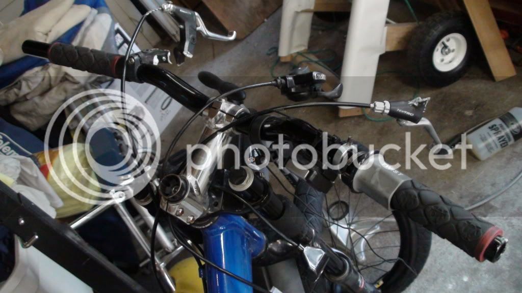

lol. I'm for now using the "power" of my shoes... One shoes on the ground makes me brake :lol:
Now I have a very dangerous bike because the brakes are not working very well. For the front brake, I spend my time adjusting the caliper but it's loose the next day. I don't know how to fix that.
And for the rear brake... there is not caliper (it broke):
Any idea where I can find the right size caliper and with quality? It seems it needs 160 mm size from the front one.
