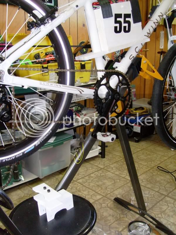

Just finished the lipo batt box for my Matt RC build in progress. The 1/2"(12.7mm) X3 1/2"(89mm) oakboard was cut to fit and liquid nail glued into the frame with a hose clamp supporting on the seat tube. Sprayed 1 coat primer so the wood grain shows thru some (not foto apparent) looks nice with gold Schwinn trim paint. The material is 1/8" sorta tough rubbery conveyor belt material. Made precise clean cuts, then hot glued inside, liquid nail outside. The board is 3.5"(88mm) and the box is 4.25"(108mm) and glued additional 5/16"(8mm) strips along the bottom R & L edges to help the box to remain in place. There's heavy duty plastic ties in a cross+ inside to reinforce its' rectangular shape. 2" wide nylon strapping (Walmart auto dept) with 2'X4" industrial velcro, found in general hardware stores; white used on the box, black on the straps. A small drop of SuperGlueGel was added to the velcro adhesive which blend together (just rubbed w/ finger). That keeps the velcro adhesive from going goey in hot weather (I hope).
This batt box holds 8 5000mA lipos (20Ahr @ 12S). My other box will hold 10 6000mA (30Ahr @ 12S) lipos and will extend behind the seat tube. Will post pic in April.
Looks like I'm committed to mounting the motor/drive underneath the BB now :twisted:

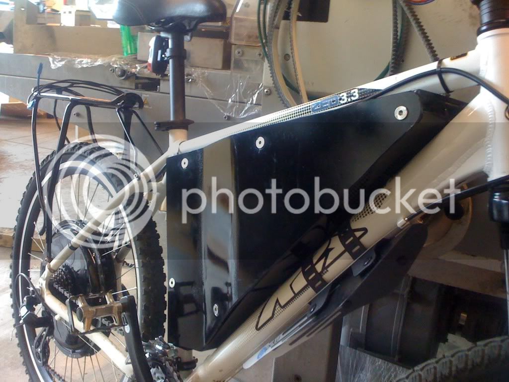

Here is my BMC build that was finished last year. It's been everything I had hoped for. It was designed just for trail riding.
It needed to be silent, stealthy and reliable.
600w BMC V2T with V3 clutch and gears
10S 8P konions at 40volts, current limited to 35amps on a clyte 72v analog controller. 24ahrs total with rear pack.
Custom battery mounts and dual custom torque arms. Cylcle analyst for battery monitor and lvc.
Top speed 21mph on flats, all 27 gears are usable and I'm able to provide useful pedal power on all gears.
Yes I like to pedal and it gets me out of the woods when I run out of power!
Max trail distance so far has been 33 miles. Going to try to break that record this year.
Decent shocks, trigger shifting and hydraulic brakes makes it fun to ride.
Added was a custom support bracket not in picture. This was needed to keep the topeak rack from breaking. I broke 2 of them before this.
Another new addition this year will be Burties timing board. This should increase my torque, speed and efficiency. Will know more once it's installed.
Last fall I was in great shape, since all I wanted to do all summer was to ride the trails. Spring is finally here and I can't wait to ride again. Bike has taken many crashes and has held up well.

Kfong,
That is one beautiful bike build. I particularly like the custom molded case!
Ambrose
Wow, Kfong; you have a mold :D How much to make more of these? How much Lipo could you pack in one of those :mrgreen:
Not sure on the amount of lipos you can store, but as you can see there is a lot of konions in that triangle. I've been avoiding lipos since they still need to be attended to when charging. The konions are a bit more rugged and can take the harsh pounding of trail riding, they are also less of a fire hazard. I calculated the weight gain and it ended up being only a couple pounds heavier for the same density. I would however be able to add more lipo capacity in that space. When these fail on me, I will see what new batts to use then. The bike is fairly well balanced, even with the rear battery pack.
My new 3010B caught fire a couple days ago, back to using the 1010B to charge. Bummed that it happed, going to have to send it back. Don't know if I would trust this charger on lipos.
Yes, I do have the mold to make more. It's labor intensive, so I won't be producing them, just not worth my time. It actually is just a protective shell, the actual battery mount is a custom CNC bracket, I can actually pull out the batteries. They are secured by 6 socket screws, and sit onto a custom cradle. Very secure, no movement even during a crash, which I have had many.

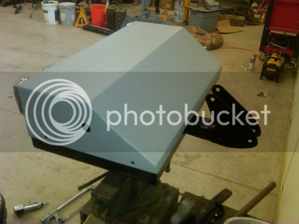

I've just finished a crude but effective battery housing, made from planed timber and plywood.
There are four Bosch Fatpacks in there at the moment, with space for another two, and the controller is in the rear bag. A bit of paint and it'll be good to go.
