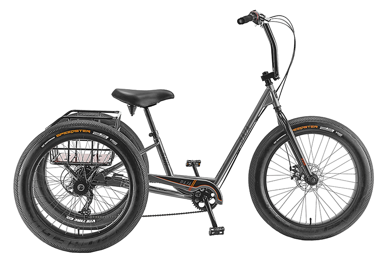

Hi Guys...
Here is my latest version...
Great frame design and battery case space (which is one of the bigest out there... available in 4.25" and 5.25' width)
from
http://kobois.com/ (ebikedeal was the old website)
A lot of room... everything fits in there,
Kelly controller 7230S 120A / 300A peak (24 - 90V) programmable wire & Bluetooth,
Hub-motor QS Motor / QS 205 H50 V3 with ferrofluid and hub sink. (inside motor treated with EL601 Red Insulating Varnish Sprayon)
Large Cycle Analyst,
Li-Ion cells VTC4 18650 21S10P (88Vdc @ 21A C-rate 14.3) all cells individually protected with fuse-wire,
AliExpress Smart BMS 16-32S (100-200-300A) programmable with wire or Bluetooth, (with LCD display)
DC-DC module 80V to 12Vdc 10A,
Hi-precision Shunt 150A/75mV,
12Vdc brushless thermostatics fans (adjustable temperature)
4 waters tight air-vents,
Industrial Marine fuse holder (up to 120A)
Polarized junction post,
Industrial panic switch - emergency shut down
Industrial selector switch SPDT 600V-63A (Group Charge - OFF - RUN)
Ignition Switch with key
Main power output connector is Anderson (charging port)
All harness and cables are passed through Nylon strain reliefs...
Power Silicon Cable Hobby King #8AWG
All electrical contacts are covered with NCP-2 battery corrosion preventative and also some Dow Corning electrical dielectric silicon.
Extra informations: I am a pretty heavy guy... (6ft - 248Lbs) and my best top speed reached in summer 2018 was 83Km/h
I have tested the maximum range with one full charge... at average speed 50-55km/h I have made about 60km. (there was 8% charge remaining)
The wheels have been replaced by motorcycle wheels 19'' X 1.6'' with 3.25 tires... it is now safer to ride on the potted holes road where I live...
