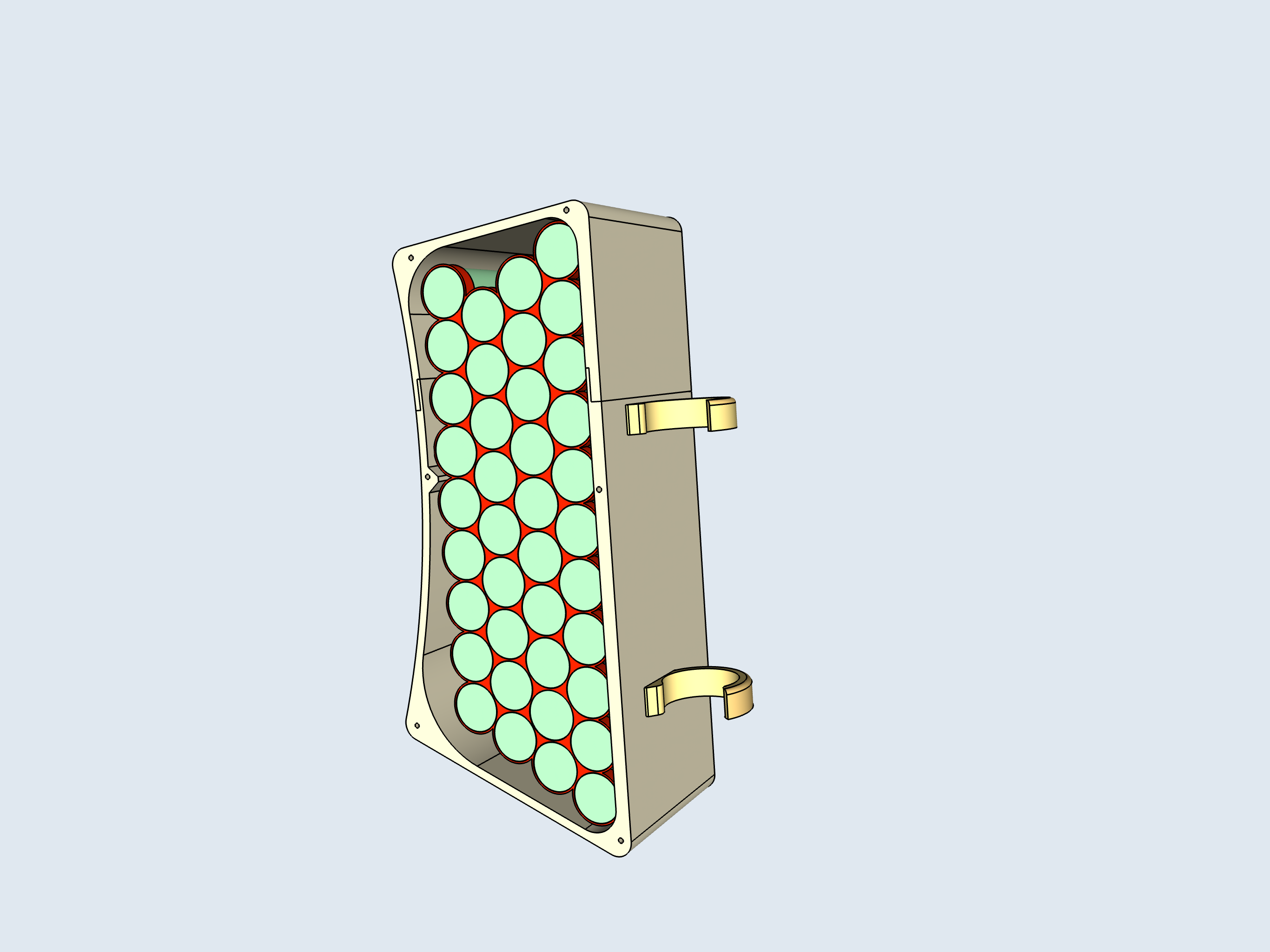

14*6 TESLA 18650 cells.
Finished ride.
And for the WIN!
3D printed perimeter. CNC router machined acrylic sides. Attached with m2,5x6 plastofast screws.
Waterproofing with gasket tape. Fully waterproof under faucet. One drop got in when submerged. The BMS's power switch is under a rubber shielding and the charge port is accessible via a M12 gore-tex valve screw, which also allows water vapor to exit the pack.
Battery sits on top of controller box and is attached with stainless steel latches.
Pack is 14S4P Samsung 25R's with a generic Chinese BMS that seems to work well.
