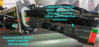

The build
When I built this bike my controller came from Grin Tech and the battery I ordered from EM3ev. I needed to change the power harness on the controller to mate it.
