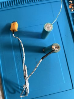

I recall seeing videos from @ZEUS-FL using Kapton tape to fasten a thermocouple probe to a battery to measure cell temp under high current discharge. The probe would fall off when the cell gets hot.
I just got a AwithZ UF20B spot welder and been doing a lot of practice welds with it. One was welding thermocouple wires to make a wire "bead" and also weld the thermocouple wires to the + and - terminal and also to the cell body. This should make much better thermo contact and will not fall off.
Edit: In the video, there are 2 thermocouples. One is welded to the negative terminal (with no connector), the other welded to the body, with a connector plugged into the meter. As can be seen, the response is immediate.
These two wire "beads" were welded with the AWithZ UF20B in gear 1. I also tested them in boiling water. Both read 212 F so the "beads" are good.
To make a wire bead, strip the wires, twist together, place on top of copper strip. There's a small square of 304 stainless at the end of the copper strip to add resistance. One welding probe presses the thermocouple wire onto the copper strip, the other probe onto the stainless. The current flow is through the thermocouple wire, through the copper strip, through the stainless. Thermocouple wires do not stick to the copper. That's a piece of soapstone. Anything non conductive should do.
I used gear 1, lowest on my AWithZ UF20B. Depending on how powerful your welder is, you may have to experiment with using longer stainless strip to control (lower) the power.
Edit: My welder probes has rounded tips. It helps to use pliers to flatten the twisted thermocouple wires first before welding so the probe is pressing against a flat instead of a round surface.
E
To spot weld thermocouple to the negative terminal, place twisted thermocouple wires on negative terminal, small strip of copper and 304 stainless held on with magnet. One welding probe press the thermocouple wire onto the negative terminal, the other probe onto the stainless. To weld onto the side body of cell, scrape a spot with razor, one probe press the thermocouple wires onto the body, the other probe on the stainless/ copper sandwich held onto the negative terminal (never on the positive terminal! will probabably start a fire or explosion)
This procedure works for me. Experiment, you may find a better way. If you do, please share.

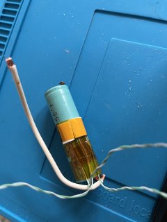

From left to right:
spot welded to negative battery terminal, taped to cell body PVC wrap, spot welded to cell body
Cell is a MX18650-26P salvaged from a bad 10S4P battery pack. I guess it's rated 2.6 Ah? Load was 5.2 A (2C) on Atorch DL24P load tester.
Highest temp was the spot welded to cell body thermocouples, then spot welded to the negative battery terminal, coolest was taped to cell body PVC wrap.
79.2F 78.6F 78.9F before test start
87.6F 85.6F 90.9F approx 4 min into test
108.5F 104.7F 113.2F approx 8 min into test
129.9F 124.3F 136.0F approx 16 min into test
Numbers are from screenshots taken from a video of the test. For some reason, I could not upload the screenshots. I get an error that they are only partially uploaded. Tried a few times - same result.
edit: I took a photo of the video on my Mac, and was able to upload the photo, which shows the test setup.
I also did a test with just 2 thermocouples, one taped to the bare can of the the body (not against the insulation), the other spot welded directly adjacent to the taped one. I feel spot welding thermocouples to the battery negative terminal is not useful since it is skewed by heat generated by resistance heating of the current flow through the battery.
From left to right: taped to metal body, spot welded to body.
Again, spot welded shows the hotter reading.

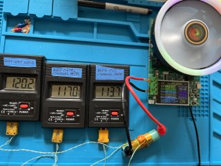

This shows the spot welded thermocouple, thermal grease, the 2nd thermocouple to be taped with thermal grease below the spot welded one, and 1/16" thick adhesive insulating foam tape.
This shows three thermocouples with foam tape and Kapton tape. Two of them have thermal grease (the one against metal body and the one against PVC body). The spot welded thermocouple does not have thermal grease.
This was taken near the end of the test:
The spot welded thermocouple reads 3.2F higher than body metal thermocouple with thermal grease, 6.5F higher than body PVC thermocouple with thermal grease.
Compared to results from post#12, thermal grease lowers the difference between spot welded thermocouple and body PVC thermocouple by 3.8F (10.3-6.5)

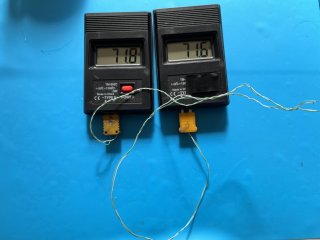

What variation in temp do you read if you use the same thermocouple (reading a steady “hot” cell temp) in all three of those TM-902C meters?
I’m often asked for temp meter recommendations and having a consistent, relatively accurate (consistency is much more important), and affordable model to recommend would be great.
I just tried the same thermocouple in my three TM-902C meters at room temp.
1. 71.8F
2. 71.6F
3. 71.8F
Edit: It'd be difficult to get a steady "hot" temp when the cell is discharging since the temp is rising.

if you are inclined to test more, perhaps having all three TC's the same distance from the bottom of the cell and cell orientated vertically in an environment with no air movement, when placed under load would perhaps change the results.

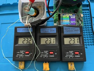

I redid the layout per your suggestion. I also found one of the thermocouples reading 1 degree F off compared to the other two, re-welded the bead so all three read equal.
Near end of test before LVC. Differences are much smaller with the changes made!
