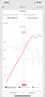

Today I had a live session via AnyDesk with Scott Drive (New Zealand).
Scott Osborne updated the firmware of the controller, changed some settings for P/I and we tested different setups for the resolver calibration. So hopefully the shut down during full acceleration is gone now. I hope to test it on a 1/8 mile event middle of June.

Had a fantastic weekend with h my daughter and brother:
  • No controller shut down
  • RT: 0,000 sec (first time)
  • made first place and got the trophy for fastest electric motorcycle (only one took part 🤣🤣🤣)
But it was to windy for my big front fairing. I stopped all runs inbetween because of hitting the light barriers by continuing …
I also have to shorten the wheel base again and find a new design for windy runs 😉

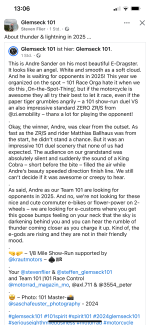

Got now the information that e-bikes competition at Glemseck 101 are banned now. Maybe to less competitors or the government decision to cut the deposits by buying an e-car or e-bike. But with vitamin b I will get a short race against a powerful compressor bike on 1/8 mile.
So let’s see what happened! I have shorten the wheelbase and already prepared for Saturday
Great weekend at Glemseck and the compressor motorcycle lost regarding no injection and left starting line.
But a new competitor with traction control took over
It was not full length 1/8 mile

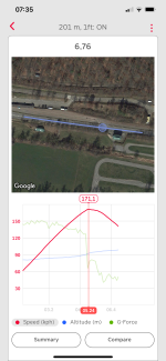

Horrible day @ ACAB - All Cars And Bikes - Tuningtreffen with Happy End althoug I lost the last Race.
1st run: slipping wheel @ start and during every speed I pull the throttle switch to full position with dancing rear wheel 😉
2nd run: forget to switch to sports mode @ starting line (250A vs 535A) 😢. My fault!!!
3rd run: bad start from starting line but then she run 😀
4th run against the matador of this track David Mitzlaff. I knowed already that I will loose (what I did) but he pull me to my actually best run!
Thanks a lot for that my friend 👍
I have really bad 60 feet times, practice, practice, practice 🤣
But I made the 1st place @ electric vehicles
