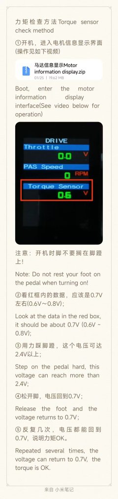

Our tech team took a look at the video. Since the noise happens even when the bike is completely still, we strongly suspect it's a Torque Sensor zero-point calibration issue. In standby mode, the controller may be picking up unstable torque signals, which makes the PWM send tiny pulses to the motor coils.

Torque sensor is showing incorrect value 1.7V. It should be ~0.7V. Did you have the same issue before installing new firmware (2026-05-26)?

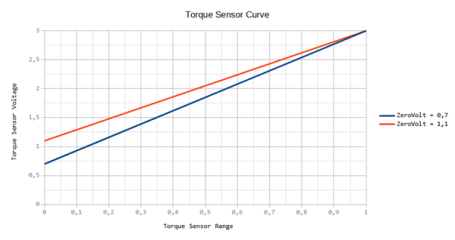

Here a timelapse from the switching on, you can see the voltage start from 0.7v and raise to 1v in only 3/4 minutes of riding. You can imagine how fast and easy is to raise to 1.7v.
