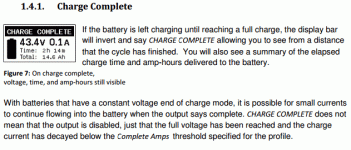

3. Is the field "Complete Amps" the current rate at which termination occurs in the CV phase or is it the current flow after termination in the Lithium chemistry profile? I think its the former but I thought I read somewhere (I can't find it now) it was the latter in what was maybe an earlier version of the manual? If it's current rate at termination point, it seems like a low default value in my case - .12 Amps for a 12 ah pack. In my other hobby chargers, I'm used to seeing C/10 (normal charge) with an option of C/20 (accurate charge).
From the manual:
With lithium profiles this is just the threshold current at which point the text across the satiator says "charge complete". It doesn't have any actual effect on the actual charge algorithm. The charger goes into CV mode and once it does that the current decays, and at some point in the process you can choose when it indicates the charge is finished.

You are right that the default threhold is on the low side for sure, so even with a fast bulk charge it can still seem like the satiator is taking a long time to charge a pack up, especially packs with a high internal resistance. A default of more like 0.3-0.4A would be more appropriate and would give the appearance that the charge is faster.
