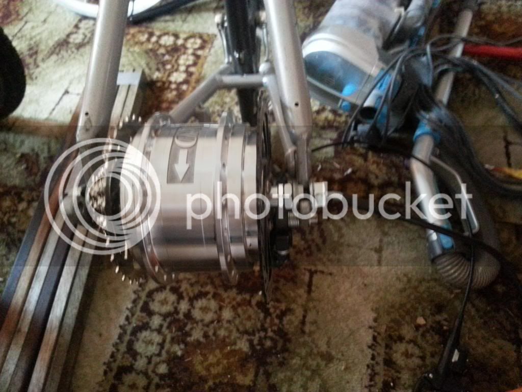

Actually, after several years of using the Q100C (Cassette), I'm ditching it.
The design has the hub section so off-set to make room for the cassette, that it is impossible to get the rim centered. I've tried several lacing techniques to no avail. Here, one can see that the rim is almost directly over the inside(of the dish)spokes and the rim is still not centered;
I have "pushed" and "pulled"(dished)the rim as far as it will go and and still lack about a 1/2" to get it aligned behind the frt. wheel and when riding, there is a twitchy feeling due to the wheels not being in alignment.
At this point, I suspose I could dish the frt. wheel to line them up, but that would move both wheels off the bike's centerline and I'm not willing to do that.
I'm going with a older Ezee V1 geared motor that I have had lying around for a number of years.
For those who want to use the Q100 on the rear, I would have to recommend the Q100H, which, of course, would have to use a free wheel.
