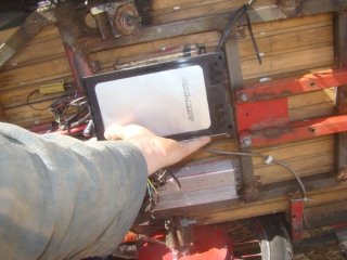

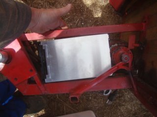

While I was preparing to do the above stuff, I also looked at the potential layouts for stacks of EIG cells to fit under the trike rather than in the cargo seatbox. They'd go in modules of four cells, 2s2p, to keep them "slim" and not take up much vertial room, if I did them in a single tray under the trike's deck, like this.
Or, make individual modules/boxes and fit them in various parts of teh frame:
The two triangular areas at the front left/right corners of the seatbox under frame are *just* too narrow to fit two modules, about half an inch. :( I could probably notch the triangulation tube so they'd fit, if I had to, but I'd rather just put the others under the deck itself. The charger is presently occupying the space one module would go in.
There's also room for a module between the two areas, along the main "keel" tube under the seatbox.
The forward underdeck area can hold at least two modules, possibly four if there's enough room to stack them between the deck and the rest of that triangulation tube that meets the cross-tube transfer axle just behind that space. Depends on how thick the modules end up, which depends on how I make them.
The area the controllers take up will hold two more modules (four if they're stacked; nothing to worry about clearance-wise).
I have to be able to fit 28 cells, for a 14s2p pack. That's 7 modules of 4 cells. So if I can fit four modules on the underdeck just behind the seatbox, and four (three) where the controllers are, I wont' need any area under the box. That leaves space for the lighting pack (4s1p) to go there instead. Or use two 4-cell modules for a 4s2p lighting pack, one in the center under-seatbox area, and one in the left area. (the charger is in the right area). Probably rather leave the center area clear, so that I can eventually move the chainline under the seatbox. rather than thru it as it is now.
I was going to move the lighting pack to the front triangle, but there's about 1/2" too little space to do that, no matter which way I orient the cells. :( I'd have to mount them outside the triangle cover panels to clear the frame.
There *is* room for one module in the space between the IGH and the cranks, between the keel and the "toptube", but that area isn't enclosed yet, so either I'd have to seal up the area or the cells. It's much easier to deal with chain issues should any arise if there's nothing in the way there, though.
The controllers presently mount flat to the underdeck with a lot of space between them. If I mount htem edge-upwards, FET-side down (in the airflow), they'll fit in the space left on either side of the modules in that area. Just have to make brackets to secure them with (presently they just screw directly to the underdeck via the end-tabs).
Moving the pack down there also potentially shortens the power cabling to the controllers, even more if I also move the breaker and cutoff switch there (not terribly practical). But it also adds some length *between* the modules, so it's really a wash on that part.
I orignally was thnking of a big battery tray under the whole deck area, but I think individual weather-sealed modules would be a better idea. Failure of one's containment either for ingress of water or egress of heat/smoke/fire in the worst-case event should leave other modules unaffected, or at least minimally so, meaning only four or eight cells at a time would be at a risk for loss.
So a possible plan is to make steel boxes that each hold 8 cells, to fit in the four places available under the deck itself. One box will only have four cells, but it'd also have the main breaker in it, reachable from the outside, plus the fuse. Could also fit the cutoff switch, but since I use that as a keyswitch, and it'd be under the trike, its not very convenient, so won't likely do that. Could add a contactor there later so the cutoff switch can still go there plus have a normal low-current keyswitch on the bars or wherever, but dont' presently havea contactor capable of 200A+ (gotta plan for the future ;) ).
Each box would have insulated-mount bolts for the cabling to the the next box, essentially making it into a standalone sealed battery, like some of the car modules.
Since they'll be sealed (with silicone at the joints most likely) then there'll be no good way to check cell voltages. I'll probably put a connector I can dustcap there, like a DB-9 or something I have a lot of from computer stuff, and then find or make dustcaps for that I can grease the edges of to keep water out.
With the modules down there close to the ground, I'll probably add whatever insulation will fit in them (rubber mats) to mitigate the road heat from baking them as much as otherwise direct heating thru the metal module casing would. That may also give them a bit of vibration-resistance.

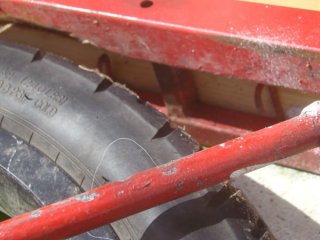

Oh, also got pics of the new fender tops, ncluding a shot from underneat inside the fender well.
as cargo strap hook points, but the screws on htem are just 1" long, and the tubes they have to go thru are also 1" wide, so that won't work. Turns out I have NO screws of any length that are the same thread pitch and diameter.
Since the pulls are probably not strong metal, drilling all the way thru and then flattening the ends by grinding would probably weaken them too much to be useful as strap tie down points. I don't think the metal is a weldable steel either, or I'd just do that.
I have a tap/die set somewhere for SAE threads, and a bunch of SAE hex head bolts, so if I find the taps I can see what the closest next-largest size is to what the existing holes are, that matches the bolts I have, then drill and tap the holes for those.
When I used these on CrazyBike2's cargo pods, they're metal plate not tube so I actually just shortened the existing screws, and it worked fine. Not presently an option on the trike, though I could weld on some tabs to teh tubes and drill the tabs to mount these the same way.
All options are more complicated than I wanted it to be. :/
