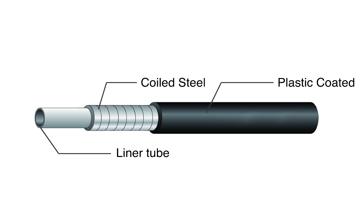

I was reading over your braking issue from the page over and thought it worth mentioning to clean the rim with brake cleaner on a rag reapplied a few times to get it really clean. If thats not it try some quality cables/sheaths.
Braking surfaces have been cleaned various ways (including sanding the rims and the pads to remove any possible contamination), none of them really effective in changing the problem.
As noted in the last post about the brakes,
https://endless-sphere.com/forums/posting.php?mode=reply&f=2&t=67833#pr1351296
the cables and housing *were* changed (albeit to whatever I had laying around that was kink-free), as well as the routing and the brake levers (from two to one, for simultaneous pull of both front brakes) which has significantly improved braking, to the point I can now skid the wheel if I want to.
So the brake problem is resolved, at least in front.
If I can ever afford some, I'd like to try out the Jagwire housing, just to see what difference it might make. Not gonna happen soon, though, because they just cut back hours at work for mysterious reasons, and I am losing about 1/4 of my income, for an indefinite period. So I don't have anything I can afford to spend on non-food non-rent non-utilities now. (and am regretting having spent anything on stuff outside those in teh last few months, even though it wasnt' much, I'll need that money now).
I do still have to add rear mechanical brakes (the electric ones are pretty effective, but when this thing is seriously loaded down, with a trailer full of dog (or a few hundred pounds of dog food) it's not enough if I really had to stop *right now*--could take 20-30 feet or more). If I can make space for them without interfering with the cargo area, I have some MC hydraulic disc brakes (rotors and calipers and hand/foot control) I'd like to put on the rear wheels--*those* should stop me pretty quick even with a load. ;)

I have Jag cable around it uses the separate aluminum ferrules in a fragile (imo) clear sheath used with cable and liner.
Top brands like xtr use linear strand with a liner
The trp disk caliper I recently installed specifically suggest linear strand.

eCue said:
I have Jag cable around it uses the separate aluminum ferrules in a fragile (imo) clear sheath.
The Jagwire I was looking at (pointed out by Chalo in another thread) uses a kevlar-lined housing, with straight wires (like shifter cable), and the kevlar keeps it from bursting under the tension of braking.
I don't have any direct experience with anything but whatever stuff comes already on bikes I get used, and the Bell brand stuff Dogman bought me some sets of when we started building this trike about 3 years ago (which is the only new cable/housing stuff I've ever had that I can recall).
I've read of a few kinds of the compressionless (straight wire) housing, but the one I see most references to is Jagwire, and the only one I ever remember the name of. :oops:
Sounds like its linear strand cable , I was disappointed with the version of Jag brake cable I bought 5 years ago. The case was uber weak period not even compared to anything :D
eCue said:
This looks like nice cable.
Might be; would have to find reviews of it in my application (like on pedicabs or other heavy-cargo haulers).
I wonder why they went with partial-spiral instead of simple straight wires? Makes it not quite as "compressionless" as straight would be.

The linear strands do have a bend in them but it seem like nice flow not too much of a spun effect. I had to look and see whats up with other brands. I have no idea what my cable does inside as its encased.
These diagrams have same spun looking wires although lightly spun..
The below ones you want to stay far away from.
Im not sure they will solve your issues as its likely the weight your stopping.
I thought of the force you have to stop with hand brakes and wow its a lot of weight buddy. Your hands must be uber strong from braking on the fly :D that would take force and make heat the two make slip when together.
Im curious if you could add the scooter rotors to your wheels ? and use their levers
I don't know what "spun effect" means, but if it is spiral at all it still isn't compressionless (just less lever travel/force needed to fully compress the housing before braking begins). So they aren't "linear" if they're spiralled, no matter what they call them.
The idea behind the straight wires is *no* lever travel or force is wasted on compressing the housing.
No, they work fine, just like any other housing--they just don't have quite as good a performance as the completely straight compressionless housing would. I happen to have one of the rare circumstances where I could probably get a significant improvement from a change to that type (though I won't know till I can afford to try someday).

I've read with curiosity the discussion about the brake cables and their sleeves.
I'm pretty skeptical about the purported issue, or maybe I don't understand it. Is the issue that you don't want to lose any lever travel in starting the braking effect? You're saying the cables stretch AND the housings compress, significantly enough it's an issue? ... Curious...
"Linear" construction of tubes for a brake cable make _no_sense_at_all_ because the tube won't be able to support much compression without failing. This is why they're typically made of square cross-section wire in a very tightly wound pitch. If you have wire stretch issues you have too small diameter wire for the application! There's just no two ways about it.
Here's what Wikipedia has to say about it:
"There is some controversy surrounding the existence of the phenomenon known as "cable stretch". Newly installed cables can seem to elongate, requiring readjustment. While it is generally agreed that inner wires actually stretch very little - if at all - housings and linings may compress slightly, and all parts may generally "settle in". Lightweight assemblies such as those used on bicycles are more susceptible to this phenomenon."
This and much more on this topic available here:
https://en.wikipedia.org/wiki/Bowden_cable
I have the compressionless housing on my Yuba cargo bike, it's a fairly long run of cable and I noticed a profound difference once I installed it, want to replace all my standard housing on other bikes with it. It's about $40.00 for a 10 yard roll of the stuff. How long is the run on the rear brake of SBC?
That's what the kevlar housing is for. (otherwise, it *would* burst)
As I said, though, I haven't actually used any yet, so couldn't say how well it would work, but it's reported to make a noticeable difference. I'd certainly try it out if I had money to spend.
I'm tempted to use some derailer housing just to test the theory, but at present the front brake will skid the wheel under most conditions (at least with the unloaded trike--still not tested with Kirin in the cargo area and Yogi on the trailer) if I set the lever for that and squeeze hard enough; can't get better braking on that wheel than that. ;)
I don't know if I have "wire stretch" issues, because the brakes work much better now with the single run (per brake) of undistorted housing in wide curves (previously at least one of my housings was two pieces butted up against each other at the ferrules, as I didn't have a single run long enough for it that I wasn't using elsewhere, and both housings had too-sharp bends in their routings).
And the single (dual-pull) lever to pull both at the same time (since my hand can't easily wrap around and apply the right pressure to two separate ones on the same side, especially on bad days when things are hurting).
I forget if I changed the cables, too, but I probably did because the other ones would've been too short for the new routing.
But I can still feel (and see) the housing move/compress, just a bit, over the approximately five feet from brake lever to brake arms. On a shorter brake cable run, with less total pressure needed to cause full braking (less inertia to overcome), it would probably be less of a problem.
If I had thicker cable and housing to go with it, I'd use it, but I don't.
I don't have mechanical rear brakes on SBC yet, but it'd probably be something like 15-20 feet with the routing over the bars, down the tiller, back along the frame, etc., if I do put cable-operated brakes there.
The front brakes (a pair of sets) are about 5 feet for each one (meaning about 10 feet of housing total, maybe a bit more).
When I was looking around (just before my hours got cut by 1/4) at the stuff, thinking I might try it out, I was seeing about the same price as you, and figured one roll would probably do all the cables on the trike plus surge brakes for the trailer(s), and leave me enough to do at least a Y-cable type for the rear brakes (one cable for the longest part of the run, then split to a Y between the two rear wheels.
Side note:
Originally when I built SBC, I added cable stops so I wouldn't have to use housing for most of the brake cable run lengths, to reduce housing friction and compression problems, and I can put cable stops in to help with that on the rear brakes since much of the path is completely straight sections, with a few curves needed in between. But I can only take out a couple of feet at most of the front brake run that way, because of the angles of things on the handlebars, tiller, and headtube/etc area.
At some areas that require housing and curves, I might be able to get away with using pulleys as guides, instead, if I can make some metal ones (plastic will just rot in the sun here), either on the lathe or drill press or by hand. If I can do this then I can shorten the cable runs, too, by potentially a couple of feet.
