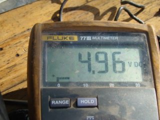

...How does it get the rotation information, from the PAS / torque sensor assembly or from a magnet mounted on a wheel?
The TDCM sensor has all of it integrated. There's a manual for it on the ebikes.ca product pages, though it's not clearly explanatory as there are several versions.
Basically the torque sensor outputs a voltage range based on the torque input, which is detected via tension on the chain vs the cranks. It does detect both cranks (others like THUN only detect the left crank), but it sees two to three times higher torque on the left than the right, probably just how the sensor is placed inside vs the twisting of the crankshaft, etc. In my case this is actually good, because my left leg is perhaps half as capable as my right (before the hurting starts seriously), so it probably comes out even.
Then it has a 12-pole "regular" PAS sensor that outputs pulses the CA counts, and between the two kinds of sensor it can also detect the direction of rotation.
A sensor with a higher number of poles (the CA supports up to 24) would have a faster response, but would still require a certain amount of rotation of pedals to get started--and the point of the motors is to not require me to hurt my joints further by pedalling from a stop with no assist--the very hardest part of the job.

At present the only thing I've figured out that's practical is to have an op-amp or transistor circuit external to the CA that takes the analog torque sensor output voltage change, and converts taht into a throttle signal to input into the CA. This can be in parallel to having the sensor input into the PAS input of the CA, and can have some sort of sensor (speed, etc) that shuts it off once the trike is moving enough for the CA to begin applying a throttle signal based on the actual TorquePAS / rotation of the cranks.
This is a relatively simple circuit I can throw together with parts I probably already have in junk around here (old audio stuff, for instance). But I'm hoping there's a solution within the CA itself (I just don't think there is, unless Grin has a custom / beta version that does this).

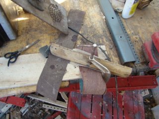

That's discussed on a previous page (there's some pics of the rotor/caliper/foot control, etc; can't find the hand control and the other caliper/rotor yet).
The idea is to make mounts on the inboard sides of the hubmotors in the rear to secure the MC rotors to, and rebuild the fender frame/etc around the motors to clear these and mount the calipers to. Not gonna happen anytime soon, but it's a potential plan.
Another thing I might do is make a really heavy-duty trailer, and use the pair of MC wheels I have on that (they're different sizes, so it'll look a little odd) and use the hydraulic brakes on that, operated via cable from the trike (or more likely, as surge brakes). It would also have a power assist, very low speed because I only really need it to get started from a stop quickly and easily, but high-torque. Couple brushed powerchair motors driving the wheels via chains with freewheels at one end or the other, powered via an old Curtis brushed controller.
These days, I don't use trailers very often, though, because SBC can haul a lot of stuff and mostly I don't need more than what it can carry. But when I do need a trailer, I *really* need it, and usually really heavy-duty at that. Iv'e been pondering this SHD-trailer for a while now (ought to start a thread on it).
slaves for the rear, each spreads, so you have a caliper you make and weld in that is similar to modern bike brakes but where when you spread ABOVE the pivot points, the brake pads run inward on the outside of the rims.

Got some more wood processed from the pallets,
and glued together some strips of sanding belt to make new ones for my sander (the purchased ones all disintegrated). Still drying in clamps, so won't know if they work till tomorrow at the earliest.

After a couple issues, I got the 2nd MXUS 450x working on the trike, to replace the bent-up HSR3548 wheel.
So...I'd replaced (and tested) one of the halls a while back, I think it was when I got it, because it had a bad one. Or maybe it was two of them. Anyway, two of them had different heatshrink than the third.
However, when I tried to wire it up to verify it's phase/hall combo on the sensored-only Grinfineon, it didn't get any response regardless of hall combo, just a tiny click. Multimeter showed two of them steady at 4.96v (with 5.01v at the red v+ wire), and the third steady at 3.53v, regardless of rotation.
Opened up the motor and verified continuity from halls to controller wires. Then verified steady voltages even with a separate magnet and teh halls pulled away from the stator. :/
How the halls would die when the mtoor wasn't even being used, or when the sensors weren't used or hooked up, back when I ran it as sensorless before getting the other MXUS...I don't know.
Took a bit to find my packet of spare halls, but I did, and replaced all three halls, and now they all work normaly.
Tried the combo thing again, and found that with all colors matching, it runs perfectly...backwards. Which would be easy to fix with the reverse wire, if I didn't already have it setup thru the relay for backing up. I didn't want to mess with the relay wiring (since I'd "water-proofed" it a bit ago), so instead I just went thru wiring combos till I found the forward one. It's been hours and I had a nap in between so I don't recall what it was, but I did get a pic, for future reference.
That said, I could eliminate the relay entirely, I guess, with both of the controllers using reverse the same way now (instead of opposite), if I were to put the motor / controller back to matching colors.
Anyhow, a quick ride around the yard tests it ok, and it definitely pulls harder from a stop than the HSR3548, and I get wheelspin in the dirt patches of teh yard (like I already did with the MXUS on the left side). Didn't get to testing it in a street ride yet, will do that for the commute tomorrow.
