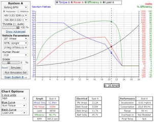

Based on the specs for the 500W version of the bike, assuming the largest battery capacity. Used an 18A controller based on the peak spec, and twice that for the phase limit, assuming no pedaling:
https://www.ebikes.ca/tools/simulator.html?motor=MBPM&batt=cust_48_0.2_32&mass=213&axis=mph&wheel=20i&hp=0&cont=cust_18_36_0.03_V
You can play with the assumptions and put in a grade if you have hills.
What's missing is the temperature data, so you can't tell whether it will over heat. I noticed reducing the weight down to 220 only increased the speed by 0.5 mph and dropping 50 watts, so I assume it wouldn't be an issue on flat or small grades.
You won't hit 70 miles unless you pedal, or if you can drop your total weight down to 145 lbs. Also looks like anything over a 3% grade will kill the motor.
EDIT: Looks like if you slow it down to 17 mph, you can get the 70 range, no pedaling.

The problem with a hub motor for a heavy cargo bike is that it will only behave optimally within a narrow range of speed. Driving the crank is a much better technical solution, because you can use the bike's gears to match load, speed, and available power in changing conditions.
With a hub motor, you either have to have an abundant surplus of power to make it all work, or you have to match the RPM of a low powered motor to the highest load it will encounter (and accepting the low cruise speed that imposes).
If you know what hub motor you are considering, and how much weight and slope you have to deal with, you can use the Grin motor simulator to figure out the speed your motor can go at its peak output, with that much weight, up that steep a slope. BLDC motors generate their maximum power at half of their free speed, so you can figure out what maximum RPM you're looking for. My guess is you'll need a fairly slow winding, or else a high powered motor, battery, and controller.
