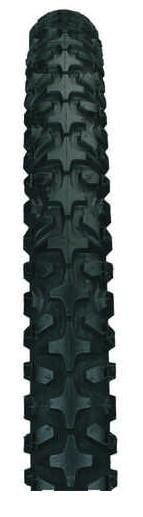

I am using these Kenda Kross Plus tires also. I found an almost new used one and just ordered another new one to match it.
morph999 said:
I use 26" Kenda Kross Plus tires. They are fast as hell. I gained a full 4 mph in speed. Pressure at 60 PSI.
