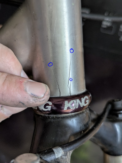

Recently got an older Ti frame, and there is a few tears/cracks coming up from the bottom of the head tube. They are far from, and do not originate nor intersect welds. It looks like they were caused by the lower headset cup being slightly bigger than the ID of the headtube, or forcibly installed at the incorrect angle.
Anyhow, some diagnosis of the damage is important, but I am here to ask advice on how to best repair. I know of no Ti welders near me. I know I could ship to one, but I will need to save some $ for that. I would like to ride in the meantime, and I actually did already take it out before I discovered this anomaly. It rode fine, aside from some creaking, which I believe it originating from this damage.
The seller I bought it from said they were unaware, and rode it for many miles. I'm supposing they might not have even known it was there, and maybe its not 'that' critical. However, every time I look at it, I cringe. So I figure, the good people of ES might have some advice...
Here is what I have done:
  • Ordered a 1.5" Gr2 Ti Hose Clamp (worm drive style) looks like 1.5mm band thickness? see photo below (anodized)
  • Ordered a 1.5" Gr5 Ti Ring Clamp (bolt and nut style) looks like 2mm band thickness? see photo below (plain)
  • Researched ALOT online about what to do, ideal is weld, sub-ideal is make a collar and press fit outside, which one of these clamps I hope to fulfill that function.
I got Ti clamps so its not dissimilar metal and potential site of corrosion. I'm supposing the ring clamp nut and bolt style will be better, because it doesn't have the cut outs for the worm drive, so its longitudinally 'stronger', its also Gr5 so an alloy that is slightly harder for tensile strength.
I'm thinking of:
  1. drilling out three holes with a bit size that matches the wall thickness, at the ends of the cracks to relieve strain (blue rings in photo)
  2. packing the crack and holes with bonding epoxy (not sure what kind yet)
  3. thin layer of anti-seize paste around the bottom circumference of the headtube
  4. mounting the Ti ring clamp on the anti-seize base, and tighten to snug
The anti-seize might be unnecessary or avoided. I don't know yet. I though about epoxying it to the frame instead, however I want to leave the option for welding open, and gluing seems like one way to contaminate the metal and decrease the quality of a weld.
Any course corrections or ideas are welcomed.
Grateful.

What if I got a 1.5"id Ti tube of sufficient wall thickness (?) cut it lengthwise to make a collar (pink in photo), then shaped it to meet the downtube and top tube with bolt flanges (yellow), almost like a Ti lug?
In any direction I go with this, would drilling the tips of the visible cracks (green dots in photo) be a baseline must?

Composite wrapping is a known and valid repair technique that can be done at home.

In sub. to finding a righteous Ti welder, is the suggested OD collar/clamp be reasonable? Its only about 7mm width around the circumference of the bottom tube base. I might have to deform (preferred) or grind one edge of the Ti clamp so that it is conformal to the OD of the tube and repair surface area.
Do they may 1.5" ID Ti seatpost binders/clamps .?. .that would be a couch size seat. Avoiding highly custom. Something simple, - maybe material isn't that critical, 304 stainless clamp with some sort of electrically isolating material along the clamp surface. I might be able to find both of those things locally...

I would find someone who knows how to weld Titanium and pay them.

Inside and out. Somebody must have taken some big jumps with that thing and come down hard.

I tagged the top of the fractures with a fine felt marker and rode around the yard, over some logs, few jackalope hops, no propagation beyond the marks. I don't plant to continue stress testing though. It's light or nigh till repairs in order.
Even if I do carbon repair, or belt clamp and carbon, or any collar and possibly inset based repair (aka no welding), is opening the crack tips with a small drill bit still recommended? I'm supposing yes... Bit diameter matching headtube thickness? Remove fork so I don't have a holey shaft...

Yes ser. I was wondering if that's possible, some big endo case -ouch. It looks more extensive, than the tear a human could produce hammering a headset cup on before stopping and saying, "...should I be hammering this hard on this frame?”
Though, it's possible it's grown over time. The seller did suggest they were the OG purchaser from the builder, and they didn't notice the damage...
comprehensive/certain
After that discovery, more so in the last 24 hours...
There looks like compression marks in the Ti structure on the opposing side of the lower headtube. Though no apparent breech of the titanium oxide surface of the wall. I have not removed the fork yet ... That might be an important insight on triage of this.

For me, the ramifications of a front end catastrophic failure are so potentially horrendous that I wouldn't consider anything less than an expert (like Moots if they do repairs) saying it was possible to salvage. Look up Ti welding; it must be done in an inert environment or you end up with Titanium Dioxide (the little particles that make white paint etc, white).
What do you guys mean you need to weld Ti in an "inert environment"? Any gas shielded welding is done in a somewhat inert environment, aluminum is just as reactive as Ti. That's what the shielding gas is for and yes you generally use pure argon for Ti and not a cheaper mix like for steel but that's not exactly exotic. For a tube section like that you also need to back purge the section but again that's not exactly exotic, you just seal up the openings with some foil tape and purge in argon.
Not saying you should just have some joe smoe weld it but welding Ti is not that crazy and you can probably find somebody who can do it.
